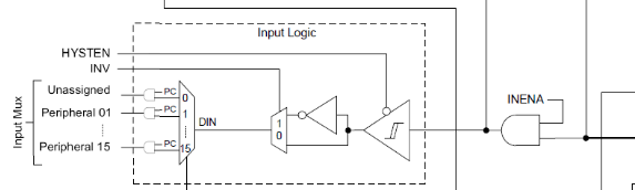

  • The hysteresis of the Schmitt trigger should help you there. You can also turn it on or off.
    Though I am not sure how that AND gate will affect things, it seems to defeat the purpose of the schmitt trigger.
  • It do provide the hysteresis function for IO.
  • What do you mean by "it"? According to the diagram the hysteresis providing schmitt trigger is inside the "input logic box" isolated by the AND gate.
    I assume that the AND gate is actually an analog transmission gate, or the schmitt trigger is useless.
  • "It" means HYSTEN bit in TRM or HYSTEN in your diagram.
    After enable this, if run some voltage test, the hysteresis behavior will be seen on the waveform.
  • Right, so the AND gate in front of the Schmitt trigger that is controlled by that bit must be a transmission gate, not a digital AND gate or the hysteresis would not take affect on any input signal, since it would be buffered by a digital AND gate.
  • Which gate are you referring to? The INENA?
    Your concern is correct, but I think this should be a diagram issue here.
    INENA must enable for a input IO, while during the hysteresis test, we can still see the hysteresis behavior.
    Very good aspect, I will check this part with docs team to make sure everything in a correct position.
  • Yes, thank you that is exactly to what I am referring to here. As I said, I suspect it is actually an analog transmission gate.
  • Does this mean that the Schmitt trigger is indeed at the very beginning of the input path?

    This is only the function diagram to better show you each function and register bit's relationship, actual circuit not looks like this.
    So don't worry about this.
