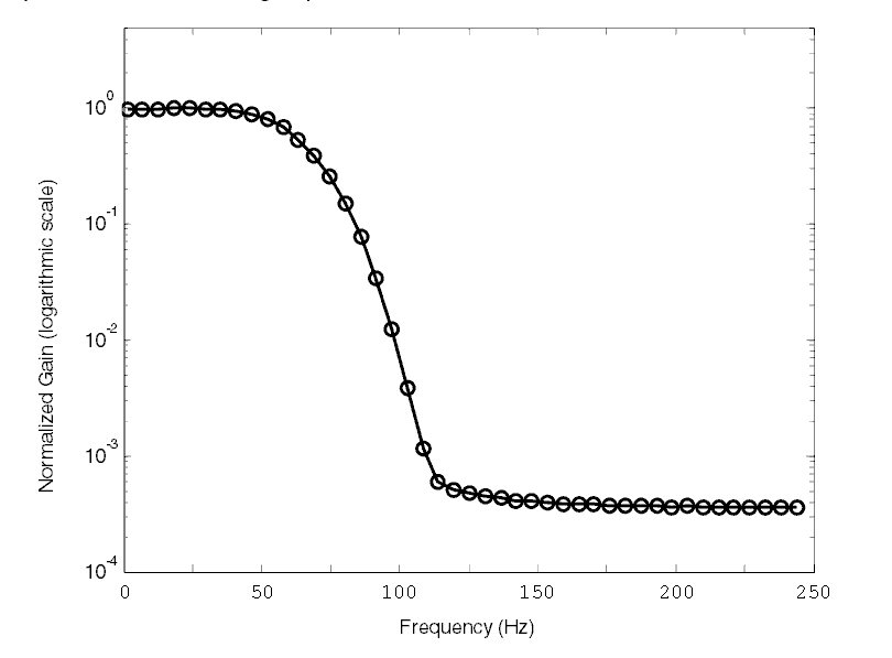

  • You said you want to calculate average of eight. Did you get that done? How did the gain vs. frequency look like?
    You also said that you used mathlab to design a low-pass filter. What are the filter coefficients? How did the gain vs. frequency look like?
    If there is no one that pulls your strings, then it must be yourself that is pulling our strings to do all sorts of elementary things for you. (Such as changing size of an array from 1000 to 500, divide an integer by 8, and count to 1 second using a 2ms timer.)

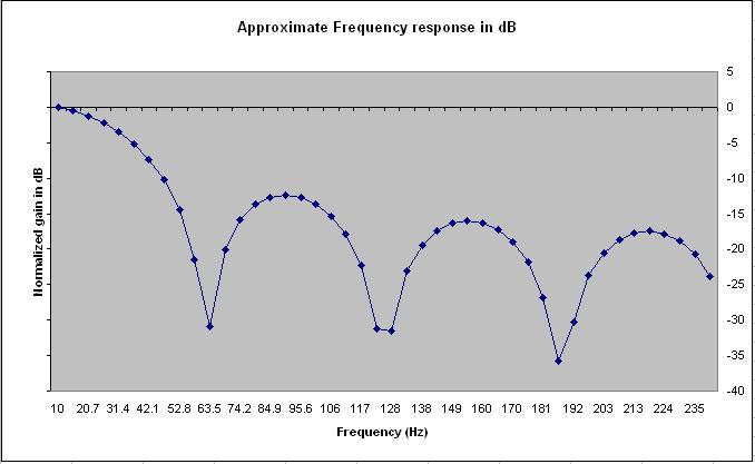

  • Sampling at 500 Hz and take "average of eight." gives this frequency response.

    But I don't know how to check the gain Vs frequency response(as in  the  image  you posted above)

    The frequency response of "average of 8" is equivalent to the set of coefficients:
    0.125000
    0.125000
    0.125000
    0.125000
    0.125000
    0.125000
    0.125000
    0.125000
    As you can see, the frequency response of "average of 8" is not very good. I think the coefficients you quoted above is even worse. They drop off too sharply just like the "average of 8". It is not worth the trouble to try it. The Low-pass filter in the TI App Note is much better, but the cutoff frequency is 75 Hz. You need a lot much more nodes to get down to 3 Hz.

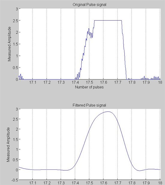

  • Hi OCY,
    Thankyou for your guidance for the digital fiters.I am actually developing a Pulse meter so thought of using digital filters for replacing analog filters but now I have other real important things to be implemented on microcontroller so thought its better to use analog filters so as not to make the micrcontroller implementation complicated.So,I am switching to analog filters removing the need for the digital filter implemenation as of now.

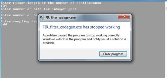

  • Thanks OCY for giving your time for helping me to understand what I am wrong with.
    The lowpass filter designed with Matlab has a length of 104 8 as attached here 5611.FIR_filter_coeff.dat),Fs=500,Fp=3,Fst=8,addition of all coefficients=1.0554 and when it is used to filter the 500 samples(of 1 sec duration) of ADC then it has the following reponse
    when I tried to generate the same filter(filter length=104 after copying the filter coefficients into FIR_filter_coeff file) with FIR_filter_codegen.exe it is showing error like this
    I really don't know whether the problem is because of large filter length or anything else.
    The controller I am using has the hardware multiplier so I guess it will be good to make a filter function using the  hardware multiplier instead of using the FIR_filter_codegen.exe tool to generate the assembly FIR_filter_function that actaully need for the controller that don't have hardware multiplier.can you suggest anything about this.
    Thanks.

    old_cow_yellow said:
    Internal to the algorithm, it needs a finite number of old input and/or output. They can be stored locally and not regarded as formal parameters.
    They could be given as 'seed' parameters, or be reset on each call with a block of data.Or are built by preceding the block whose data is to be filtered with some data that doesn't result in (valid) output values. How many preceding values are required depends on the filter.
    This is why the SD16 requires three conversions whose results are to be discarded, after being switched on or after changing the input channel: the digital filter of the SD16 requires these results to settle.
    However, to draw a picture ofdigital filtering: a very simple low-pass filter can be imagined as a function that gets a value and emits a value that is, if possible, the input value, but differs at most by x from its previous output value). The output of such a simple digital filter function would pretty much match the output of a slew-rate limited analog amplifier.
    I think this example is a good visualization of OCYs "Filtering is usually an on-going continuous process"
