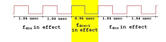

Hi Sir,
I am using MSP430g2231 microcontroller to generate a clock frequency of 38kHz in one of the GPIO pin(P1.4).
That means I am trying to generate a clock cycle pulses of period "26micro seconds"(1/38khz). I have used the
configurations and written the code as shown below. The problem that I am facing is, when I am trying to check
the result in oscilloscope the cycle period varies in between 32, 34 and 38 micro seconds. So my question is
what am I doing wrong with my code? Is there any wrong with my clock selection..since I am using calibrated
clock (internal) values of 1Mhz or I am doing wrong in setting values of TimerA CCR0 value? Please provide the
support and help. Thanks.
