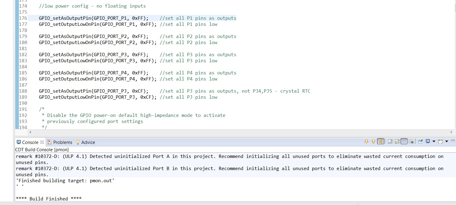

Not a big deal, but it looks like some problem with ULP advisor and maybe can be fixed. On FRAM Launchpad ...
see the picture.

Jan,
thanks for the feedback, I will forward this to the ULP team.
