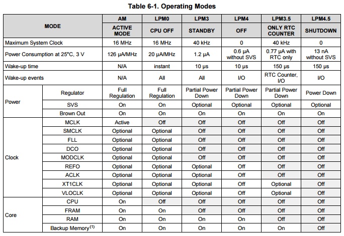

  • Hello Phil,
    I am going to try and replicate your issue on my end but first I have to request some MSP430FR2033 samples as I do not have any around the office. Have you tried using any other FR2033 devices to see if the issue exists on multiples MCUs? What revision number is the device you are currently using?
    Ryan

  • Phil,
    I have been able to replicate your issue on my end and am currently investigating to find a root cause.
    Ryan
  • Hi Phil,
    I have confirmed with the Quality Team that backup memory does not exist on the MSP430FR2033 device. The datasheet will be revised accordingly, I apologize for the confusion.
    Ryan
