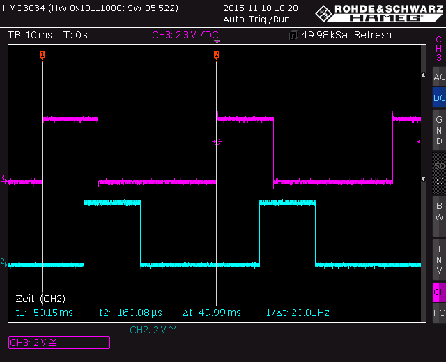

I have a code that generates a PWM. Can someone tell me how to add code to the existing to generate a PWM and give it a delay to certain amount and get that out through one of the ports?
  • Hi Yashaswy!

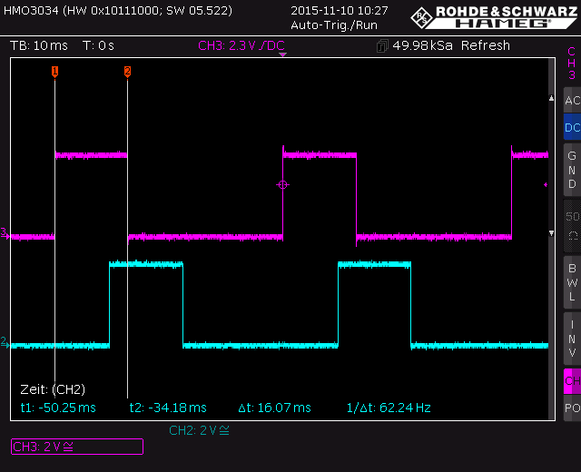

    Here is some code for you that does the following: The first PWM is on P1.4 (TB0.1) and has a duty-cycle of 16ms. The second PWM on P1.3 (TA1.2) starts 12ms later and also has a duty-cycle of 16ms. Both have a period of 50ms.
    Connect your probes here:
    #FreeSampleCode

    P1.4 (TB0.1) is the purple line, P1.3 (TA1.2) is the blue one:
    Have fun!
    Dennis
