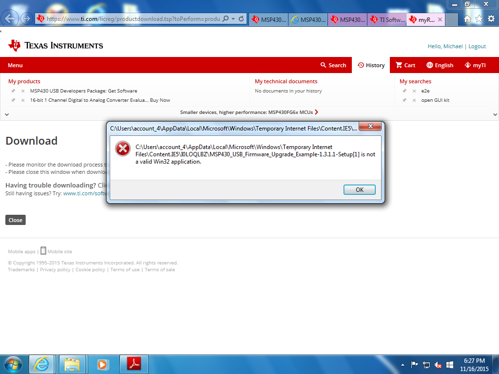

       The software does not install correctly:
        Below is a snapshot of the error message that I receive:
      No matter what format I save the file in, I get the same error message that you see above.
      Can anyone tell me a solution to this problem?
  • By the way, the operating system that I am using is Windows 7 Professional 32 bit.
  • Also, please take notice that I have changed the name of the download example to *.exe and I still get the same error message.
    My apologies, for not mentioning this when I first started this post.
  • I have inserted a snapshot of what I see on my computer screen for your convenience.
  • I should have explicitly wrote that I changed the filename extension to *.exe, however, I received the same error message. I will try to insert a snapshot of what I see on my computer below:
  • Hi Michael,
    Sorry for the long delay. I used Internet Explorer 11 to download the same firmware upgrader software and also saw that it left off the .exe when it downloaded (I am reporting this issue, but unfortunately is something I've seen across a few different websites when using IE). But if I add the .exe to the end of the file manually, I am able to run it just fine (though I do have a 64-bit system). I also found that if I used Chrome as my browser to download the file instead, it does correctly download with the .exe.
    Can you please try to use another browser (Chrome or Firefox) to download the file again and see if this resolves your issue? I will also try to see if we have any 32-bit machine here to confirm that it works ok.

  • Hi Michael,
    I saw that you tried adding the .exe but we were unable to reproduce your issue here, even on a 32-bit windows system, so it is hard to say what your problem is other than the error message you saw is a windows error message that is fairly generic and we unfortunately can't give much more guidance since we don't have your exact PC to test on and are unable to reproduce on our 32-bit windows system here.

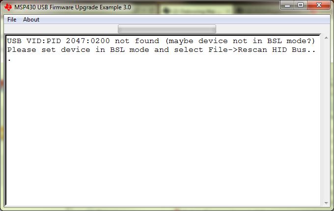

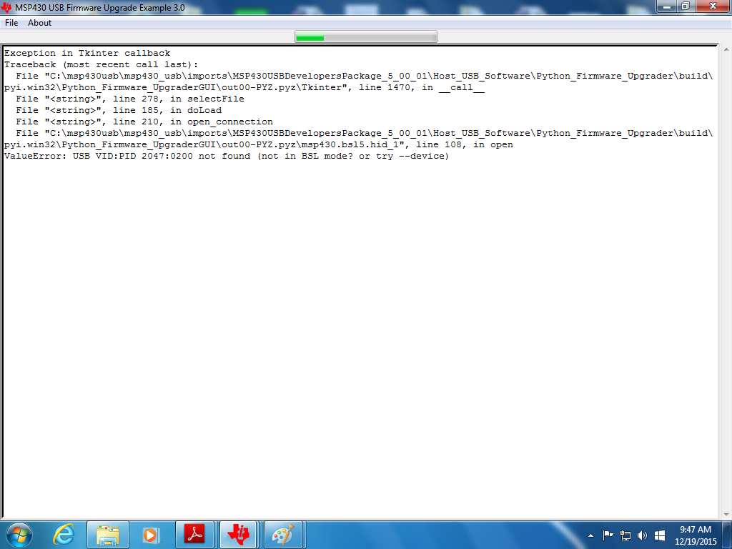

    I tried option 1 and 2. Option 2 resulted in an error that is not convenient to fix at this time. I will elaborate upon this error in future messages if necessary. I am focusing upon option 1 because I believe that a quick solution may exist:
    I am new to the Python Firmware Upgrader software. I am not certain if I was successful in putting the MSP430F in bootstrap loader mode correctly. However, whether I did or not put the MSP430F in bootstrap loader mode, I know that an error condition exists.
    Please interpret the following error messages that I have received.
    Screenshots of the error messages are provided either below this message or in the following posts (there is problem with this website menu options - with regard to inserting files). Please take notice that the MSP430F launchpad was configured in the "new in the box" state before the Python program was utilized (this information will serve as a reference point for you).

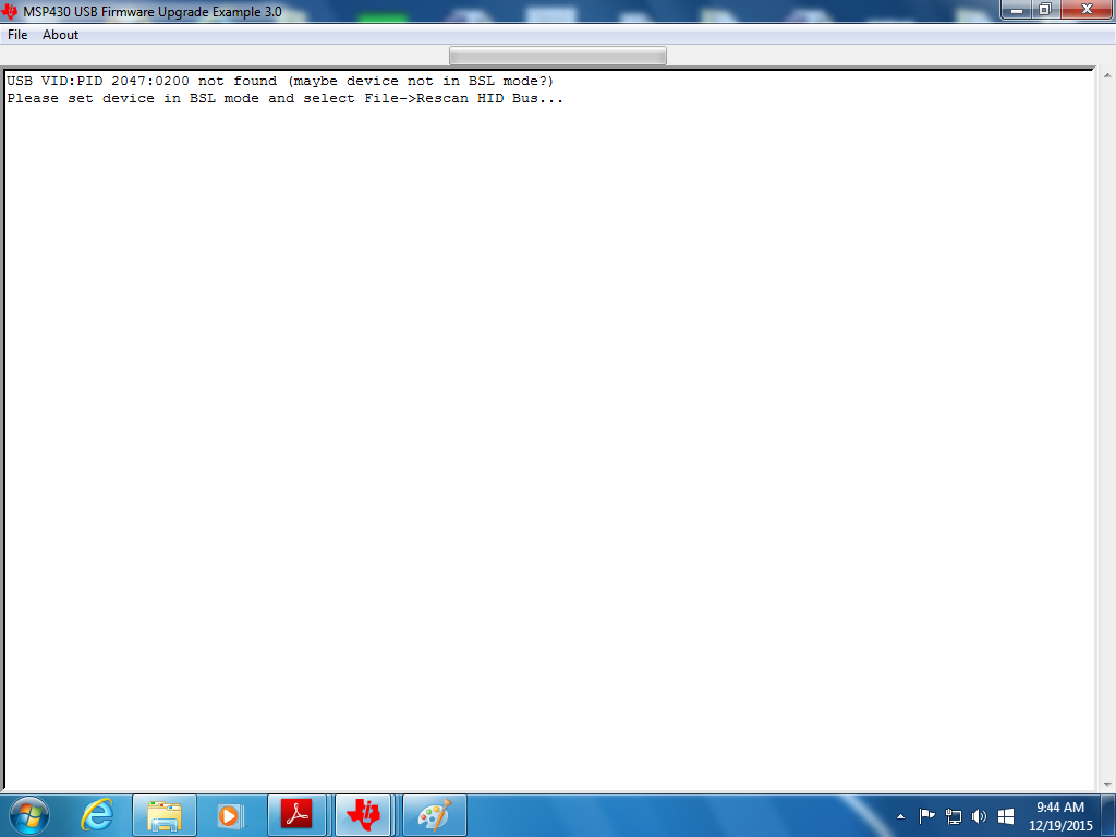

  • Dear Katie;
    I managed to upload the screenshots.

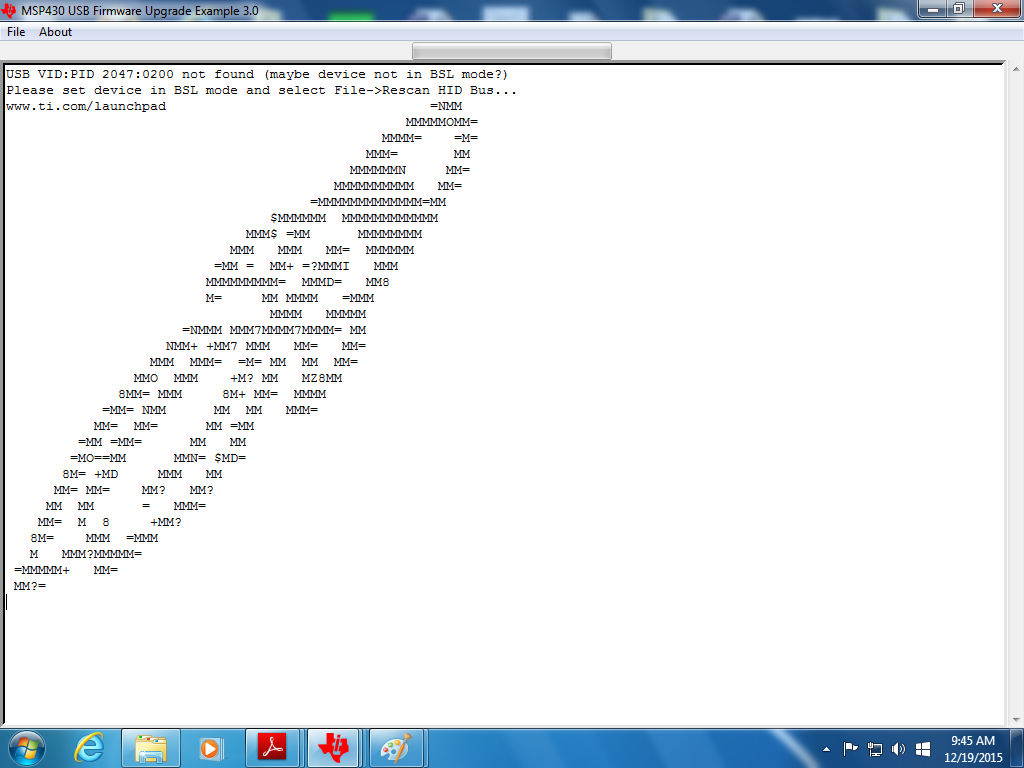

    Can you show me a screenshot of what I should see when the MSP430 bootloader has made proper connectivity using the Python Firmware Upgrader?
    I would like to verify if the second screenshot showing the rocket necessarily implies that I got the boot loader in its proper state (or is the screenshot of the rocket only implying that a text editor function is working but not the boot loader function).

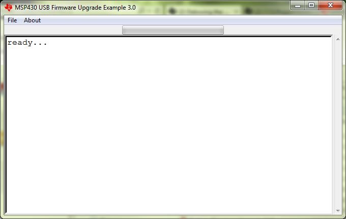

  • Hi Michael,
    Thanks for the information and the images. From my testing, I can see the same messages as you if I do not have the device in BSL mode (except for the rocket image - I'm actually not sure how you got that to show up).
    Here is some comparison:
    If I am not already in BSL mode when I start the GUI, I see this:
    If I then unplug the board, hold down the button on the Launchpad marked "BSL", insert USB, and release the button the Launchpad marked "BSL", my part should now be in BSL mode. After doing this, do File > Rescan HID bus in the GUI. You should see this if it finds the board in BSL mode:
    At this point, you now can successfully select and load code without error.
    As for the other image you saw (with the Tkinter callback exception message), I only see this error if I have my device NOT in BSL mode (did not say ready...) and try to select a file to load anyway. You'll get that error because the part wasn't in BSL mode yet.
    Katie

    I wanted to answer your question when you wrote:
    Thanks for the information and the images. From my testing, I can see the same messages as you if I do not have the device in BSL mode (except for the rocket image - I'm actually not sure how you got that to show up)."
    When you wrote:
    " (except for the rocket image - I'm actually not sure how you got that to show up)."
    When you get the MSP430F5529 USB Launchpad in the mail, there are a couple of programs already installed in the Launchpad right out of the box. When I got my USB Launchpad, the instructions were to open any text editor (have blinking cursor operating within the text editor) and then to press a pushbutton. When you pressed the pushbutton, the MSP430F would then demonstrate USB connectivity by sending that rocket image to the text editor via the USB cable.
