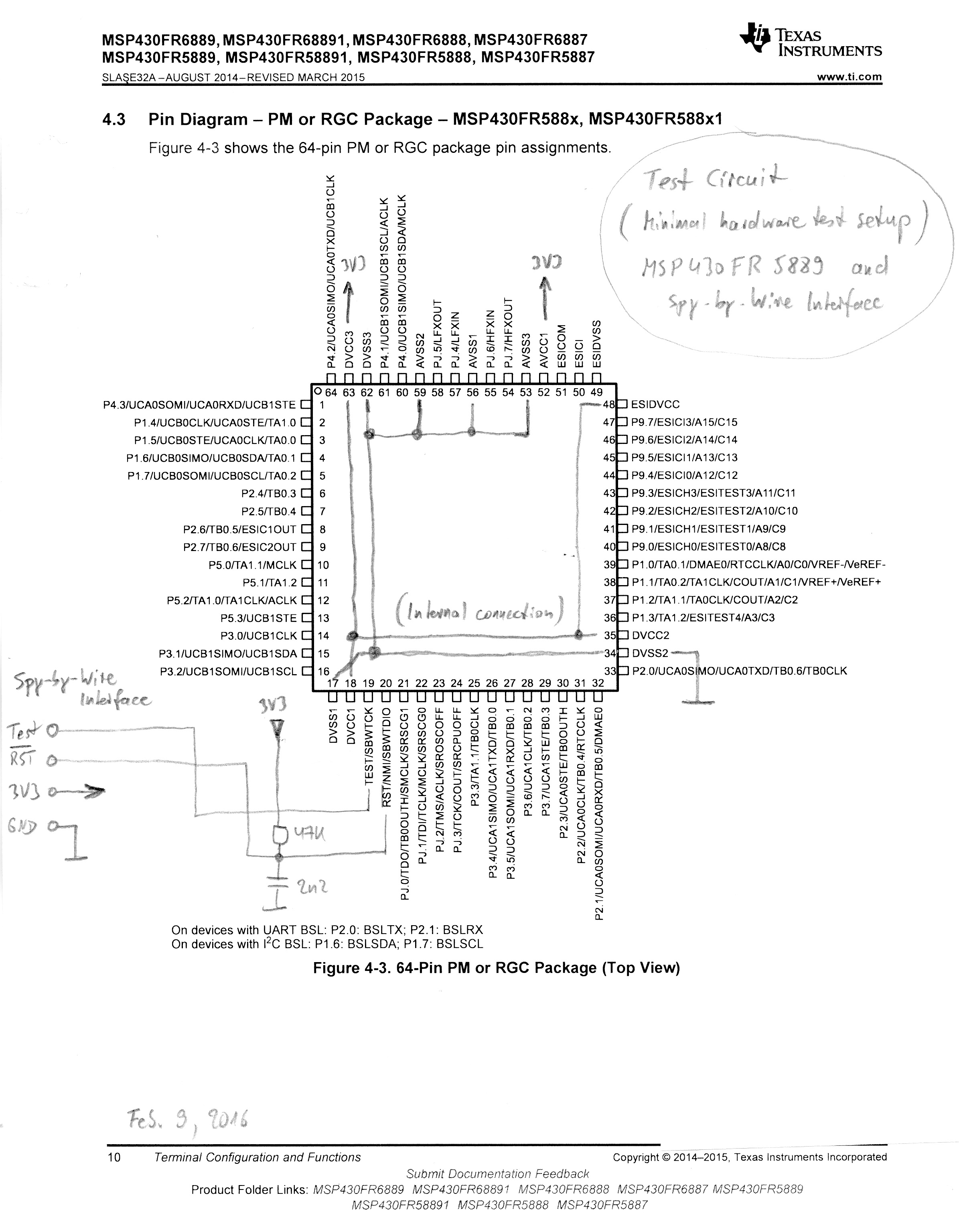

    In the meantime we prepared a test ciruit with a minimum hardware setup: MSP430FR5889 with a Spy-by-Wire interface
    and the supply voltage only, see attached circuit diagram of the test setup.

  • Can you try replacing the 2.2nF capacitor on RST to 1nF? 2.2nF is the max, and if there is any additional parasitic capacitance from long traces/wires, it can drive the effective capacitance above 2.2nF.

  • Does "internal connection" mean, you have not connected all the power pins outside of the processor?
  • Hi Mike,
    I replaced on two boards the 2.2 nF capacitor against a 1.0 nF and a 560 pF capacitor. Then I checked the communication to the board by JTAG and Spy-by-Wire by using the FlashPro430 adapter. The result was: unfortunately nothing changed, the communication still ends at "erasing memory", see screen shot above.

  • Hi Dennis,
    I have some prototype PCBs, where all of the VCC and VSS terminals are connected directly to the supply voltage and ground (as recommended in all application sheets). Further I prepared a handmade board with the minimum hardware to verify the communication problems. This handmade board is in fact connected to VCC and GND by a single wire to terminal 52 and 63 (VCC) and 34 (GND) only. I have checked before, that all VCC and GND terminals are internally connected. The behavior and the error messages of the programmer is for all boards the same. This simple design is not recommended for a reliable application, only for test purposes.

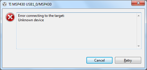

    I think the problem is the MSP-FETU430IF. With ccs6 it is giving the Message "Unknown Device". Can this be fixed?
    Khalil
  • Khalil,
    Are you sure you are using the MSP-FET430UIF (big white box) and not the MSP-FET (slightly smaller black box)?  The MSP-FET supports BSL, but the FET430UIF does not.
    What version of CCS are you using (full version number, e.g. 6.1.0.00104) and what version of the compiler are you using (e.g. TI v4.4.3).  You can find the CCS version by going to Help -> About, and you can find the compiler version in the Project Properties, under the General tab.
    Mike
  • yes, I used MSP-FET430UIF "MSP430 USB-Debug-Interface". We ordered the MSP-FET.
    ccsv6 Version: 6.1.2.00015 , compiler version TI v15.12.0.LTS.
    I guess maybe the MSP430FR5889 is only supported with MSP-FET not by "MSP-FET430UIF".

  • I posted the Debug results using ccsv6 and MSP-FET430UIF on 12 Feb "Error connecting to the device, Unknown Device". Debugging with IAR and MSP-FET430UIF brought "Fatal Error".
