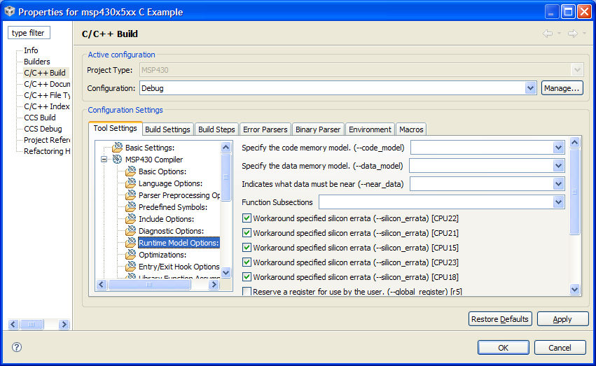

    I guess you are using CCS. The current version of CCS (4.1.3) supports compiler workarounds for the following CPU silicon bugs:
    CPU15, 18, 21, 22, 23 and 40.
    However, you need to select support for these items MANUALLY (this is in the works for the next release).
    1. CPU15, 18, 21, 22, 23 can be selected in: Project Properties --> C/C++ Build --> Tools Settings --> MSP430 Compiler --> Runtime Model Options
    The next CCS release (version 4.2) will include CPU40 in the list.

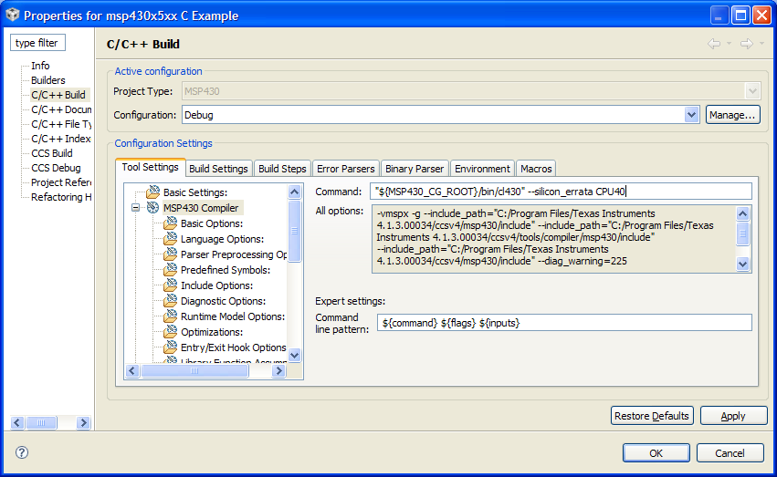

    2.  CPU40
    Due to a bug in CCSv4.1.3 CPU40 doesn't show in the list, but is still supported by the compiler. Please manually add "--silicon_errata=CPU40" in Project Properties --> C/C++ Build --> Tools Settings --> MSP430 Compiler --> Command:
    CCS should actually be clever enough to do the settings automatically. Unfortunately, this is not the case at the moment (i.e. in CCSv4.1.3 and the new CCSv4.2, which is about to be released). This will be fixed in the next release i.e. CCSv4.2.1.
    IAR doesn't offer a workaround for CPU40 yet, but this will follow in the next release.
    Markus

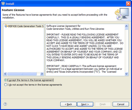

  • I have CCSv4.1.3.  I also compile from the command line since all of my code/tools are in a version controlled data base and we use scripts to build.  I have added the --silicon_errata=CPU40 to my command line and I receive an error while compiling that I have a bad argument to option and it says that the arguments should be one of the following {CPU15 CPU18 CPU21 CPU22 CPU23}.  The version of cl430.exe that shows up is v3.2.3.  When I look for updates when I'm in CCS it says everything is up to date.
  • Hi Philip,

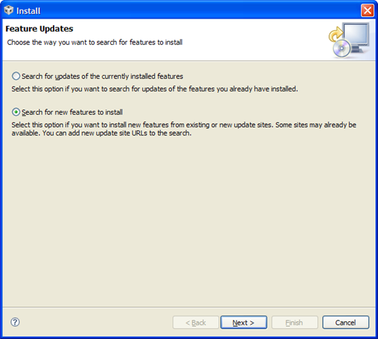

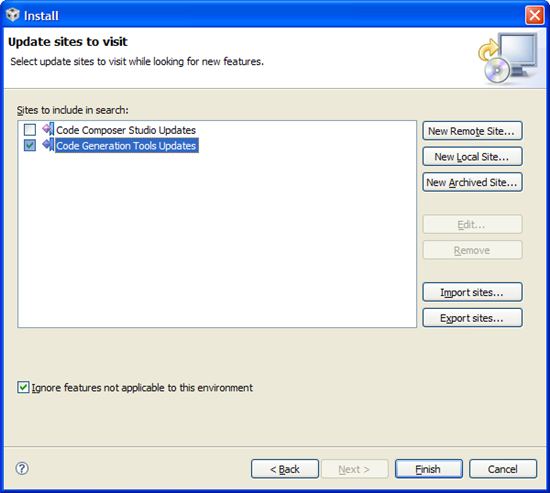

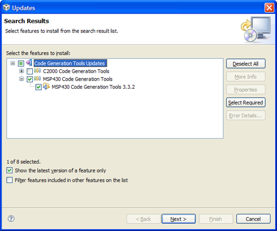

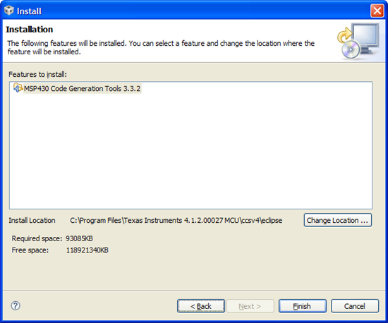

    Your version of the CCS code generation tools (CGT) does not have support for the CPU40 issue. You need to use CGTv3.3.0 or later. The CCS update manager should automatically show and update the CGT, but there seems to be a bug - I just verified this on my PC with the same version that you have. Now there are two options:
    1. You download and install the latest CCS version (BTW, we'll release CCSv4.2 next week, it handles all CPU bug workarounds automatically - no need to add strings to the command line)
    2. You update your current version. If you do so, the current version of the CGT will be replaced by the latest one. If you don't want to do that, please go with option 1. As mentioned, there seems to be a bug in the updater utility that doesn't automatically install the latest CGT, but you can still trigger the update manually:
    1. Click HELP --> SOFTWARE UPDATES --> FIND AND INSTALL...
    2. CCS will show the update dialog. Please select SEARCH FOR NEW FEATURES TO INSTALL and clock NEXT (see screenshot)
    3. In the next step you need to make CCS look for new CGTs, therefore select CODE GENERATION TOOLS UPDATES and click NEXT (see screenshot)
    4. CCS will now list all available updates. Please check the MSP430 CODE GENERATION TOOLS 3.3.3 (as shown below) and click NEXT
    5. Accept the License agreement
    6. Start Installation by clicking FINISH in the last step
    Hope this helps!
    Markus
