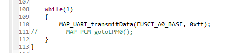

Hi guys,
I'm using the demo "uart_pc_echo_12mhz_brclk.c". I only added a command to the main loop to send a die (0xff) to the UART.

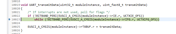

It works, I run the program and I continually receive the value "0xff" on the computer. When I send some data through the computer, and the program enters the interrupt routine of the Rx_UART, it returns the value that I received through the Tx_UART, but does not return to the main routine. It gets stuck in a loop that I do not understand:
Can someone explain me better why can not go back to the main routine? Am I forgetting some FLAG?
Follow complete code:

while(1)
MAP_UART_transmitData(EUSCI_A0_BASE, 0xff);
// MAP_PCM_gotoLPM0();

  • Will,
    The way the code is written is the device will go back to sleep on ISR exit. This is enabled by the following line in the code before you go into your while(1) loop.
    MAP_Interrupt_enableSleepOnIsrExit();
    Therefore, when the device executes an ISR, you have a setting that enables sleep when the ISR exits and then the device is sent to sleep.
    Do not enable Sleep On ISR exit, and you will operate as expected.
    You can ensure this by using this function:
    Interrupt_disableSleepOnIsrExit();
  • Wakefield,
    I did this and now the program runs the way I need it.
    Thanks for your help! It was of great value to me.
