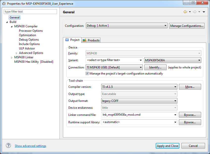

I'm starting to work with the MSP-EXP430F5438 and I'm trying to use the User Experience sample software.
My 1st issue was that it was not doing anything and the screen would just be blank with the backlight on... so while searching for help I found this thread and followed the directions to install the original compiler used when the project was created (v4.1.5) but it still doesn't work... in fact I get a bunch of errors (that don't tell me a whole lot) and a few warnings where seems like the biggest issue is that the toolchain cannot find an entry point in the project.
Looks like when the TI employee was able to reproduce and fix this issue last year they used CCS 7... and I'm now using CCS 8 (installed latest available 8.0.0.00016) so I don't know if something is not getting imported correctly or what the deal is.
Has anybody tried to use the sample code recently? Maybe some TI person can help?
Thanks!
PS - See screenshots and full list of errors I get below...

    thanks for posting your question.
    I've tried to import and build the MSP-EXP430F5438 User Experience and tried both CCS version 6 and 8 as well as the TI v4.1.5 and the most recent one coming along with CCS v8. I didn't see any errors though.
    Did you import the project via Project->Import CCS Projects and then Browse to the proper project included in MSPWare? If not, please try to do it that way and let me know if you still get those error messages.
    Britta
  • Thanks for your reply Britta,
    Just FYI - I had originally downloaded the example code from the link provided in the MSP-EXP430F5438 User Guide ( www.ti.com/.../slac227 ).
    So after reading your comment I downloaded the MSPWare and imported the CSS project from the folder below:
    C:\ti\msp\MSP430Ware_3_80_04_05\examples\boards\MSP-EXP430F5438\src
    I noticed that the difference between this and what I originally downloaded seem to be a minor linker change in the IAR project.
    After trying with it out I still have the same build problems... (100 errors, 4 warnings)
    I'm not sure what "Error 2" by gmake.exe may be but I'm starting to think that it may be a make utility confusion issue since I have other toolchains installed some of which required their specific make utility.
    Do you know any details about the "Error 2" or if there's a way to be sure that CCS is using the correct make utility?
    Also... you said that you tried "the most recent one coming along with CCS v8"... you mean the latest compiler? If so... did you try running it and confirmed that the User Experience code worked? (i.e. LCD menu works) Because for me, it did compile with the latest compiler when I originally installed CC8 but the code doesn't work on the board... other users had reported the similar issue with CCS7 and the solution seemed to be to install the older compiler used for creating the project, but that's how I got to this point where I get build errors.
    Thank you.

  • Ok... problem solved.
    I switched to use a laptop where I actually have admin rights since I don't in the one I was first trying and have to use a temporary admin login whenever I need to install something or change something.
    First attempt (using compiler 4.1.5 from the get-go) still gave me some errors when trying to build te library for the 1st time but... the antivirus popped up some warning messages so I decided I'd try again but with the antivirus disabled, which I can do in this laptop and that was it... no build issues and the code does work... I can see the LCD and run the demos.
    Even though the problem is solved I would like to know whether this would have to hear from TI about whether I will always need to disable the antivirus for working on CCS and have admin rights or if it is just the antivirus... which programs should I try to configure as exceptions to allow CSS to work.
    Thank you!
