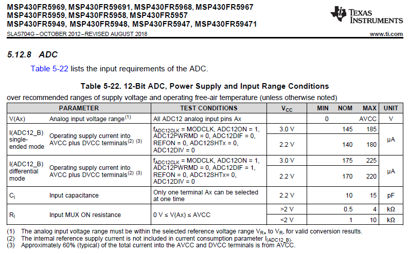

I was wondering if someone has more details about the sample and hold (S&H) circuit of the embedded ADC.
I suppose that the S&H has a switch to do the sampling and a capacitor to hold the voltage. How much are the on-resistance of this switch and the holding capacitance? In the datasheet, the only values specified are the MUX-on resistance and the input capacitance. Maybe the same “switch” of the MUX is employed to do the sampling, and the input capacitance behaves as a holding capacitance. Is that possible?
Best regards!

    My doubt is not about how to calculate the sampling time for a given circuit, but it is about which capacitance is employed as a sampling cap. Taking into account the data provided in the datasheet, it seems that the input capacitance (10 pF) is used as a sampling cap. I thought, maybe I am wrong, that after the MUX there was a sample and hold circuit with its own holding capacitor, which is not specified (or this is the 10 pF??)

  • Ferran,
    you understanding is correct the Ci which is max 15 pF is the sampling capacitance including all the parastics from bonding, pad and switches and this is what is important for correct ADC ussage. And this is the only value which is important to estimate the sampling time. Otherwise we need to seperate all the values which would not have a benefit for our customers.

  • Ferran,
    I checked the design and there is nothing in the nF range implemented so please take the 15pF max value. I mean the MUX it self is the only "barrier" or resistive path to the samplign cap that's why it mainly contributes to this.
    So you can imagine that this complex ultra lower power ADC architectures does not only consist of a simple switch and a simple cap. Everything is aligned to lowest power and performance. Because this is TI IP details on the architecture are not disclosed which makes no sense at all for the proper ussage. For using the ADC all important parameters are specified and published. The user guide describes that it is a SAR based ADC and how this works can be found in the literature. I hope this helps to answer all your questions.
