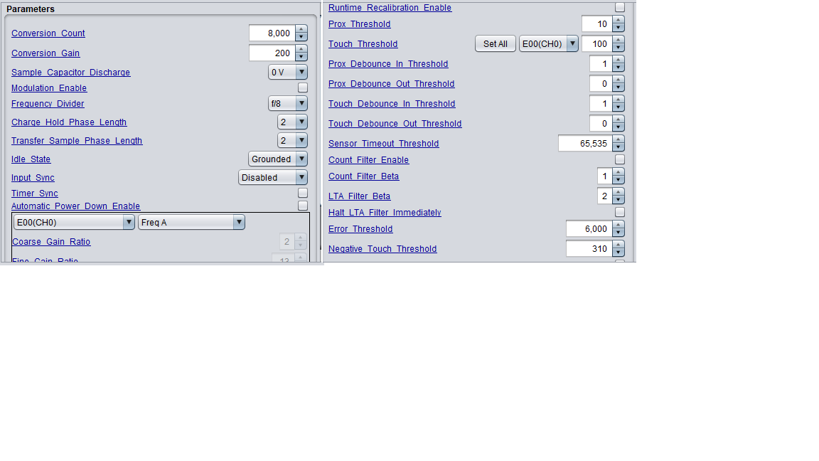

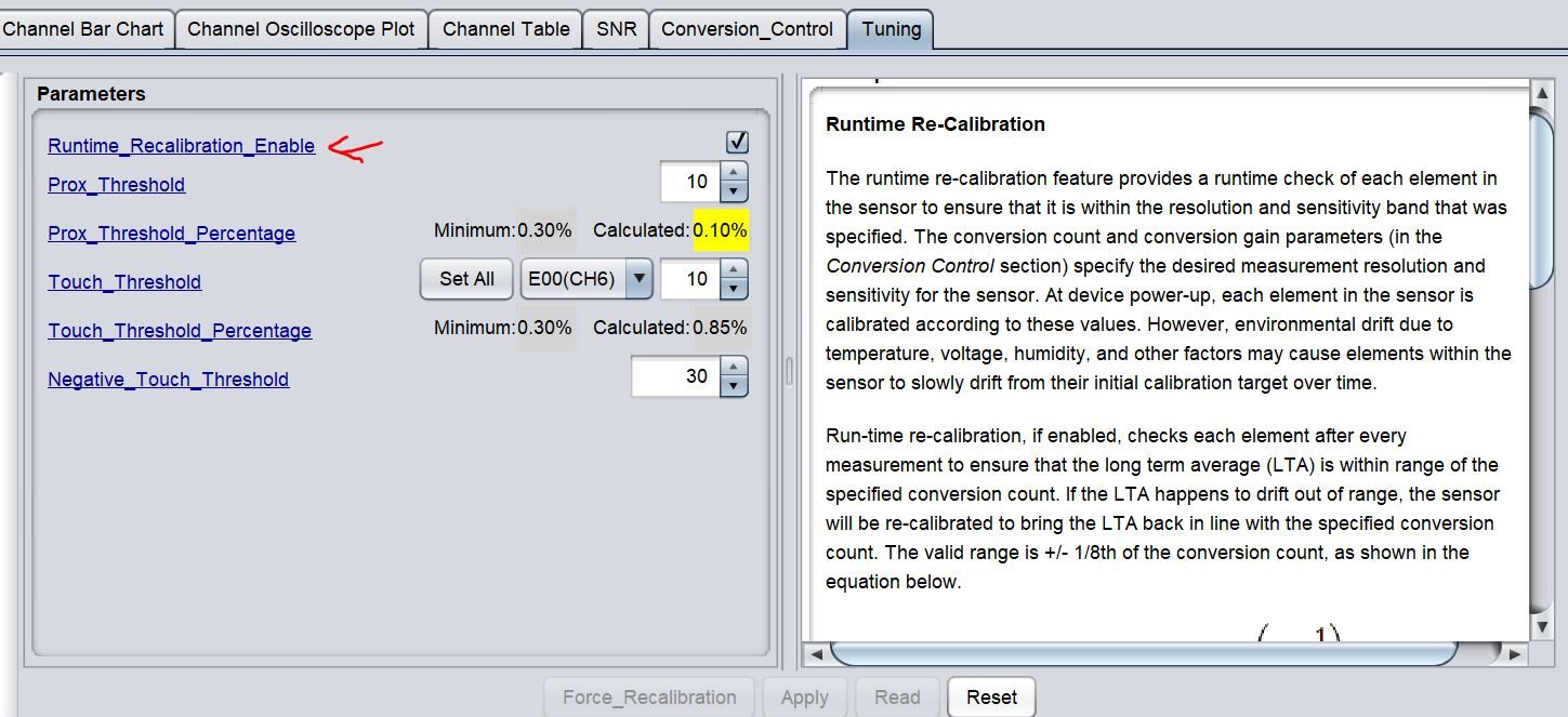

When I make proximity design with Captivate Studio design centre. I confirm the created code has been programmed in MCU with latest parameters. I have issue as follows that I think something should go wrong with my parameter setting:
1. Max Count Error always happens, even if I changed different electrode. I confirm HW connection is all right and I can check variation of count data with trend I expected;
2. SNR does not work after pressing'Measure SNR', always grey without any feedback;
3. The count data sometimes normal with tiny floating means it's alive but some times just a stable value unless touch electrode with a drop , no environment changed during the whole process.
I have no reference regarding the parameter setting, I set the conversion count very high with high conversion Gain with purpose of large increase for delta of count before and after proximity happens and can be enough margin to distinguish out of background noise.Could you please give me some suggestions for fixing these issue?Thanks! Attached is my parameter setting.
B.R
FANS

  • Hi Yuke,
    Your conversion count is set to high
    Try to reset all the settings and then set converison count to 1000
    Ling

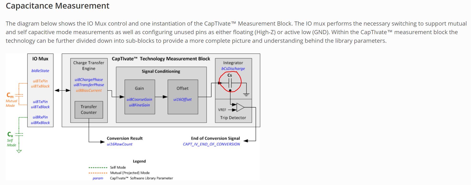

    Q1: I haven't ticked recalibration and press calibration on GUI, then I wonder if the count value I read from GUI plot is just raw data of real transfered charge relate to switch freq and voltage only? Or does it has relation with parameters of signal conditioning (conversion count,gain and offset)?
    Q2: Regarding the parameter, count value is judged by Voltage, switch freq, C external,C parastic and Csample, and I heard Csample is a fixed value.In that case, the parameter 'conversion count' seems just used to caculate the gain and offset and has nothing to do with actually transfered number of charge on Csample. Then question comes, I don't know real input Q(Ctouch+Cparastic), I don't know real Q(Csample) how do I know what's the proper conversion gain for setting? Unless the design center normalized the real Q(sample) to  my conversion count parameter and tell me the proper Gain  I need to set....Then I can set coarse gain and fine gain accordingly. If my understanding is true, why can't I set conversion count much higher to have better resolution?
    Q3: I want to know the concept of conversion, that's not relate to charge transfer, just relate to data processing(some cacluation work like normalizing if I'm correct), so only have time cost for the whole system, right?

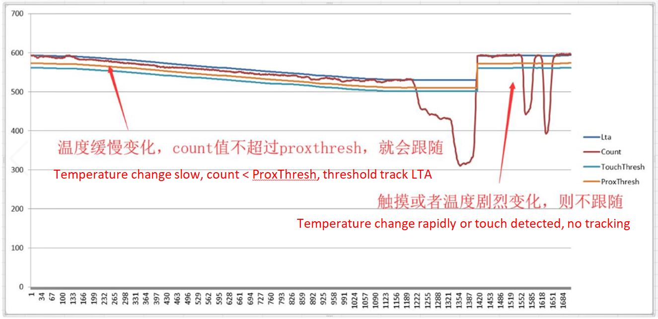

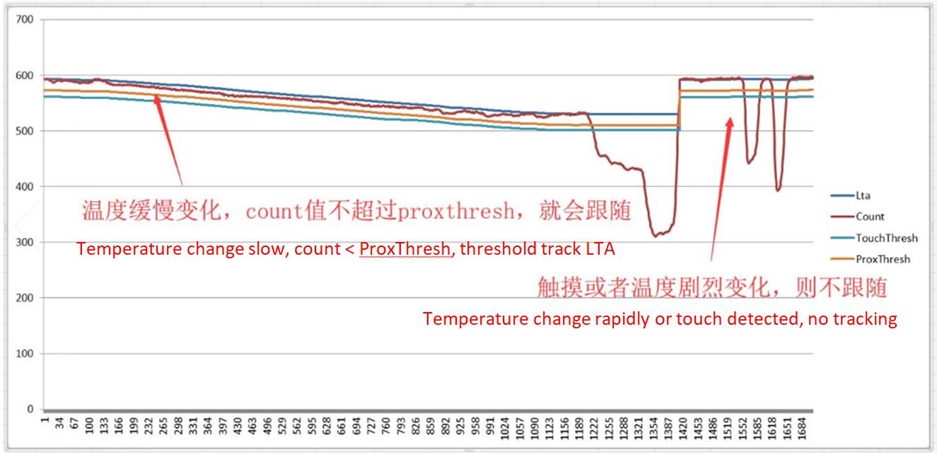

    I use the silicon F430FR2512IRH to do Approximity sensor design for 5cm distance via CapTIvate center(studio), I need to test the raw count data from 20 C to 50C , we have prob that temperature will increase dramatically in a short time.During test  I find that the delta of  count value decrease dramatically with hot temperature compared with relatively cooling temperature point which makes it's hard to distinguish the real trigger for approximity with highest temperature such as 50C. I tried to improve this by increasing sensitivity and resolution by adjusting parameters.The proximity behaviour for my application is for long term proximity, which means detecting people proximity and stay (maybe distance will change during the stay but just can be considered in short time as noise). I want to set parameters for distinguish the poor count delta in hot temp point out by largely improving the resolution based on a high sensitivity. I don't think regularly adjusting LTA is a good idea because temperature can change rapidly or slowly judged by the weather, I hope to fix this by other way. Thanks!
    B.R
    FAN

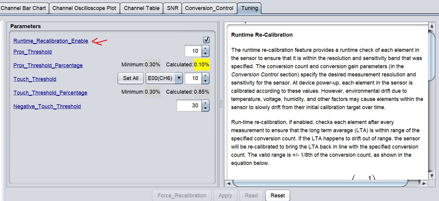

  • Hi Yuke,
    Regarding to temperature shift, CapTIvate library provide environment tracing feature. If temperature change slowly, threhold will track LTA change.
    If LTA drift out of 1 +/- 1/8th of the conversion count range, a re-calibration will be triggerd.
    Ling

  • Hi Yuke,
    CapTIvate use charge transfer method to measure capacitance which means without internal sampleing capacitor it will not work.
