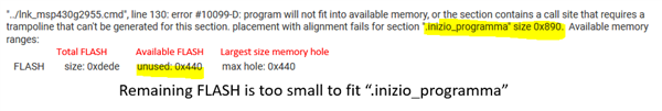

Now I want to use code composer studio version 10, to program in assembler and in with C in the future,
I have translate assemble program from Iar to code composer and for this, I need to cut the firmware  approxmately
1 kbye anyway I have this error
//*************************** START ******************************************//
"../lnk_msp430g2955.cmd", line 130: error #10099-D: program will not fit into available memory, or the section contains a call site that requires a trampoline that can't be generated for this section. placement with alignment fails for section ".inizio_programma" size 0x890.  Available memory ranges:
   FLASH        size: 0xdede       unused: 0x440        max hole: 0x440
The configuration memory file is so

Honestly I don’t understand why the compiler give me this error and why one portion of memory is unused and is not possible to use

    now Compile right but the program do not running I will check why.
    t ocompile i must reduce the firmware
    my code is only assembler not C code, my processor is msp430g2955
    Is normal that with from Iar to Code composer the optmimizzation is
    so different?
    with iar my full firmware start from 2100 and finish to 0xFFCE
    to compile with code composer  the same code I must reduce it almost for 4 kb
    is normal ?

    That doesn't sound right.  It's true that the CCS compiler may not create as small code footprint as IAR, but 4kb is a big difference.
  • HDenis
    I calculate bettert, the space lost is from 2.5k and 3 kb not 4 kb sorry for bad information , but i think are the same a lot and not justified
    because my code is only in assembler so is not possible.
    I have in my code 5 languages and have disabled 4 languages to compile right, for 25. to 3 k.
    I have cheched also how the ccs compile, and all address are consecutive, example
    my structure have many files in base at the function,
    file 1    start to 0x2100 and finish  0x222F
    file 2  start 0x2230  and so on, so is right
    I have also some include file and are compile with consecutive address.
    i don't find in the memory the free space zone.
    there is some setting to optimize the code ? I have not found it

  • Hi Denis
    I found the problem,
    I have used the directive .include so some routine I have insert in the program like include because I want consecutive program and not call or branch, I used directive .include , in a portion of my program i put
    .include " targer.asm", I inadvertently have copying the same file inside the program tree with name target.asm.
    the compiler don't give me any error and compiled both files, also if had the same name and same label.
    I think is because with iar is not necessary to declare nothing
    and with ccs if are not declared like .def .global etc are local declaration and don't see of the rest of the program.
    I see also that form translation from iar to ccs there are some mistake because the iar knowing the /* before comment and */ at the end of the comment, example
    /* this is all commet
    this is all commet
    this is all commet
    */ until here is all comment,
    /* simbol for open comment line
    */simbol for closing comment line
    ccs don't know this structure so if is disabled the code in this manner in the ccs is compiled, example:
    */ cmp.w ...
    jeq.... in iar is not compile, ccs is compiled
    bit.b.... in iar is not compile, ccs is compiled
    mov.w in iar is not compile, ccs is compiled
    sorry for mistake and thank you for your cooperation
