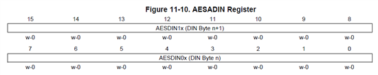

  • BTW, the driverlib AES implementation in MSP430ware is subtly broken. If the examples AES_ex1 and AES_ex2 used FIPS-197 data instead of a repeating single byte value for it's test arrays this would be immediately obvious.
    The problem is that you're loading a 16 bit register from a byte array, but you load the key with a different word alignment than the data. The FIPS example looks like this:
    Key:        000102030405060708090a0b0c0d0e0f
    Plaintext:  00112233445566778899aabbccddeeff
    Ciphertext: 69c4e0d86a7b0430d8cdb78070b4c55a
    To make this work with driverlib, you must load the arrays like this:
    unsigned char Data[16] = {0x11, 0x00, 0x33, 0x22, 0x55, 0x44, 0x77, 0x66, 0x99, 0x88, 0xbb, \
     0xaa, 0xdd, 0xcc, 0xff, 0xee};
    unsigned char CipherKey[16] = {0x00, 0x01, 0x02, 0x03, 0x04, 0x05, 0x06, 0x07, 0x08, 0x09, \
     0x0a, 0x0b, 0x0c, 0x0d, 0x0e, 0x0f};
    i.e. the Data is byte-swapped, but the CipherKey is not.
    The resulting Ciphertext will also be byte-swapped: c469d8e07b6a3004cdd880b7b4705ac5.
    The fix is simple - just swap the order bytes are loaded into "tempVariable" and "encryptedData"
    in AES_encryptData().
    I haven't tested any of the Decrypt functions, but I assume they will have similar issues.

  • Adam,
    FYI, regarding your first feedback, I had some time today to look at the source code of the AES, and found the bug here:
    AES_setCipherKey() loads byte-by-byte correctly (the 16-bit AESAKEY register's [High Byte][Low Byte] = [byte[n+1]][byte[n]])
    aes.c said:
    for (i = 0; i < 16; i = i + 2)
        //HWREG(baseAddress + OFS_AESAKEY) = ( unsigned int)(( unsigned int)CipherKey[i] | ( unsigned int) (CipherKey[i + 1] << 8));
        tempVariable = (unsigned int)(CipherKey[i]);
       tempVariable = tempVariable | ((unsigned int)(CipherKey[i + 1]) << 8);
       HWREG(baseAddress + OFS_AESAKEY) = tempVariable;
    This order (byte n = low byte, byte n+1 = high byte) is the same across all buffer registers
    AES_encryptData() loads the high-byte/low-byte incorrectly, swapping them in the process
    aes.c said:
    // Write data to encrypt to module
        //HWREG(baseAddress + OFS_AESADIN) = ( unsigned int)(( unsigned int)Data[i] | ( unsigned int) (Data[i + 1] << 8));
        tempVariable = (unsigned int)(Data[i+1]);
        tempVariable = tempVariable | ((unsigned int)(Data[i]) << 8);
        HWREG(baseAddress + OFS_AESADIN) = tempVariable;
    The decryption functions (with/without generation keys) also mix up the order of the bytes and need to be fixed as well. I filed a bug against this for DriverLib, and we should be able to roll the fix into the code soon.
    Thanks again for the feedback!
    Dung

  • Hello Dung,
    I am implementig AES128 on MSP430 right now, using Driverlib source code, which is very helpful by the way.
    I also found this bug in aes256.c that I'm currently using (but still in AES128 mode), and did the same correction than you did in aes.c.
    I think there is still something wrong though, in the way we have to read / write to the AES registers in word access.
    For instance, with the FIPS-197 test vectors (previous example) :
    If these values are indeed written the standard way, with MSB at the left and LSB at the right, then the following arrays :
    unsigned char Data[16] =      {0x00, 0x11, 0x22, 0x33, 0x44, 0x55, 0x66, 0x77, 0x88, 0x99, 0xaa, \
                                   0xbb, 0xcc, 0xdd, 0xee, 0xff};
    are representing values with Data[0] and CipherKey[0] being the MSBs, and Data[15] and CipherKey[15] being the LSBs.
    However,
    In the source code (with the previous bug correction already done), the values written in the registers are tempVariable = {Data[i+1] , Data[i]} for AESADIN and  tempVariable = {CipherKey[i+1] , CipherKey[i]} for AESAKEY.
    That means you are taking index [i+1] for High Byte, and index [i] for Low Byte, whereas the arrays are filled the opposite way !
    In this example, the source code writes in register AESAKEY, for each loop iteration :
    0100
    0302
    0504
    0d0c
    0f0e
    That means AESAKEY register is filled with swapped bytes (01 should be Low Byte, not High Byte, etc...).
    We have to write words from MSW to LSW, whereas each word is written the other way around, from LSB to MSB.
    Same thing happens for AESADIN :
    1100
    3322
    5544
    ddcc
    ffee
    The reading of AESDOUT brings the same issue :
    c469
    d8e0
    b470
    5ac5
    Whereas the Ciphertext is 69c4e0d86a7b0430d8cdb78070b4c55a.
    That means we have to swap bytes in order to have the correct ciphertext (which has to be read with byte swapping too !)
    If we don't swap the bytes while writing to AESAKEY and AESADIN, the result is not correct.
    In the datasheet, what is called (Byte n = BIT[7:0]) is the High Byte, and what is called (Byte n+1 = BIT[15:8]) is the Low Byte.
    This is consistent with how the arrays are filled (n <=> [i] and (n+1) <=> [i+1] ), but it is the opposite of what you wrote in your post:
    " AES_setCipherKey() loads byte-by-byte correctly (the 16-bit AESAKEY register's [High Byte][Low Byte] = [byte[n+1]][byte[n]]) "
    It could be helpful to clarify in the datasheet, that
    - in byte access, the first byte we have to write (in[0]) is the MSB, and the first byte we read (out[0]) is the MSB. The datasheet just tells about in[0] and out[0] without telling what it represents. By reading FIPS-197 it could only be the MSB, so maybe a reference to this specification would be appropriate ?
    - in word access, the first bytes we have to write are the MSW, but in little-endian mode (in[1]in[0]), and the first bytes we read are the MSW, but in little-endian mode (out[1]out[0]). This is really not obvious when reading the datasheet.
    Could you please check this on your side and confirm or infirm this information?
    Thanks for your help.
    Kind Regards,
    Sebastien
