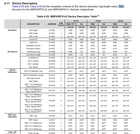

    on the new 5xx devices, a unique Die Record is stored on the device at the fab in the device's TLV Structures.  It includes info such as the Wafer Lot ID, the device's X and Y coordinates on the wafer and test results.   the combination of these numbers are globally unique and can be used by your application for identification.   the location of the TLV structures is listed in the datasheet.  For example, search for "TVL" in the MSP430F5438 datasheet.

  • To extract the wafer/lot and X and Y positions, look at memory locations 0x1A08 to 0x1AFF.
    0x1A08 should be 08, 0x1A09 should be 0xA
    If that is true, then
    0x1A0A is a uint32 with lot number
    0x1A0E is a uint16 with X coordinate (probably < 256)
    0x1A10 is a uint16 with Y coordinate (probably < 256)
    If you need a 8-byte MAC address, copy the bytes from 0x1A0A in a uint64 (little endian) as follows

  • Details can be found in Datasheet, as follow:
    The code is sth like:
