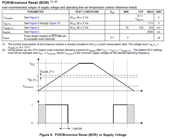

The BOR is a very simple circuit that holds the MSP430 in reset until VCC reaches a threshold voltage. As seen below, in Figure 8, the BOR threshold is max 1.71 V + 210 mV. It has been seen as low as 1.5V. When VCC is rising and reaches this threshold, Reset is released after a small delay, Td(bor), which is max 2ms in this case. There is a time delay to allow VCC to rise to a reasonable voltage before releasing reset. This is what allows the BOR thershold to vary from chip to chip.
When VCC is falling, the BOR puts the MSP430 in reset once VCC hits the BOR threshold without the V_hys added in, so max 1.71V.
