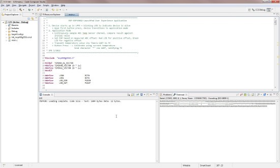

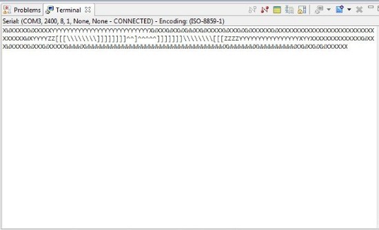

  • NIKET AGRAWAL said:
    ...there seems no output on the TERMINAL window of CCS(version 5).I am running the sample codes I got for MSP430g2553 on launchpad.
    View > Other > Terminal > Terminal

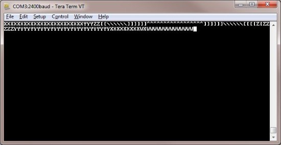

    This output is correct.  "W" corresponds to 87 °F since W is decimal 87 in the ASCII table.  This sequence shows the temperature rise and then fall.
    NIKET AGRAWAL said:
    Which terminal to use(other than Hyperterminal)?
    Any is fine.  This preference is up to you.  Here are the terminal programs I use:
    Code Composer Studio > View > Other > Terminal > Terminal
    Putty
    HTerm
    TeraTerm

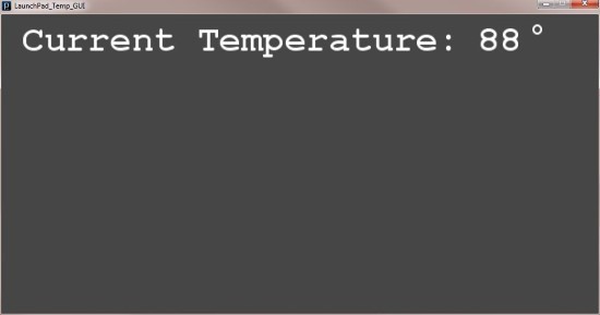

    Here is how it looks on TeraTerm
    This is my setup:
    Hardware: MSP-EXP430G2
    Device: MSP430G2553
    IDE: Code Composer Studio  Version: 5.3.0.00090
    Firmware: C:\MSP430_LaunchPad\Solutions\Lab2\Files\Temperature_Sense_Demo.txt
        Getting Started with the MSP430 LaunchPad Workshop
        Find, "The installation file for the workshop labs"
        Make a new project and run Lab2
    You can also verify the UART communication using the GUI for that project.
