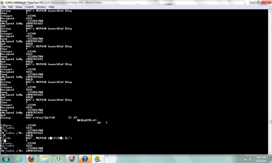

So I have been trying to incorporate the tiny printf() function I found from msp430launchpad.com into my code and I am having some strange issues.
http://www.msp430launchpad.com/2012/06/using-printf.html

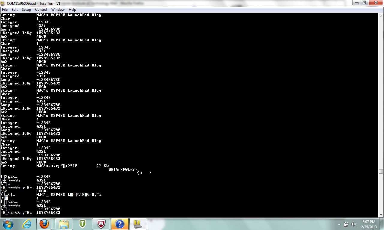

Most of the time it will not print strings from ROM (FLASH) correctly (they end up as the first character of the string followed by . but will print integers (long and short, signed and unsigned) and hex values fine.  See my attached code named "blink.c".
The only way it will work is if the program has been loaded onto the IC and I disconnect the power (via the JTAG connector), reconnect it, and close and then reopen Tera Term.
Does anyone have any idea why this isn't working properly?

  • When I disconnect power from the MCU and reconnect (RESET), sometimes after it has been reconnected it will start outputting gibberish for the strings declared in ROM.
    This is easily fixed however if I Reset the terminal program (disconnect or close Tera Term and then re-open and/or start a new connection).  It will then correctly display the strings and printf statements WITHOUT resetting the program on the uP.
    This is very strange,  I am using an RS-485 interface configured for only Tx from the uP to be displayed on the Terminal program, I'm wondering if I am possibly having a strange reflection issue?  I notice that during programming often the terminal will display some random characters.
    Thanks guys I really appreciate any insight on this problem
  • It's known that a lot of PC serial ports get into funky states if junk data is received (either badly timed, wrong baud rate, etc). By closing and reopening the terminal emulator you are causing the PC to reset it's serial port hardware.
    You should make sure that your target hardware suppresses sending on the serial line while programming and before the USCI is completely configured.
