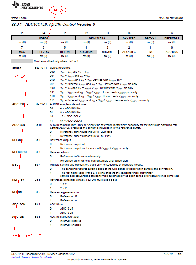

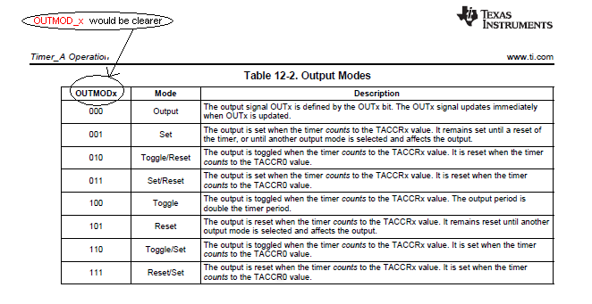

    And if anyone from Ti is listening let me say that while I find most of your documentation pretty darn good, I find one thing in your tables that was confusing for me as a recent user of your micro. And that is your neglect to use the underscore in describing the particular mode in your tables, when in fact the underscore is essential. For example, (or BZW as Jens would say), you use OUTMODx when you could prevent the engineer from hunting for the actual mnemonic by using OUTMOD_x. Or worse, as in this case,  OUTMODx actually has a value when x = 0 and caused a problem for me when I used OUTMOD0 rather than OUTMOD_x.  Edit: OUTMOD_0.
    Here's an example from User Guide slau144i p372:

  • Robert Cowsill said:
    That's a good point, Joseph. I suggest you submit that feedback directly to TI using the link in the page footer of the user guide.
    Robert,
       Done. Pretty nice feature in the manual to provide a link in the footer for feedback.
    Sorry, I have to disagree. The users guide defines the bits only. The defines with underlines (or even double-underlines) are convenience defines. Enumerations. They are not defined in the register descriptions anywhere, and therefore do not belong into lists too. However, a different notation could be used, especially in this table, since there is no OUTMOD111 or OUTMOD101 (which people could assume by replacing the x with the value in the table).
    Of course it wouldn't hurt to explain the nomenclature way better. However, you won't see any 'underline define' anywhere in the users guide tables or register descriptions. But since they are used in some of the examples, they shoul dbe explained in detail (well, I bet people wouldn't read the chapter with the explanation then - people only read what they think they'll need - without the knowledge to know what they need)
    Actually, you're right there Jens-Michael. I was concerned about the "collision" between the nomenclature in the user guide and the "wrong" set of constants in the header. Changing the user guide to match the other set of constants probably isn't the best way to fix that issue after all.

    "Of course it wouldn't hurt to explain the nomenclature way better. However, you won't see any 'underline define' anywhere in the users guide tables or register descriptions."
    That's my point. Why leave out a simple underline when including it just makes sense. And it's of no benefit to have two names for the same object, especially when there can be conflict with the same name.
    At this stage in my learning curve of the MSP430 I now know to search the appropriate header file or look through example code to quickly find the actual mnemonic. But it would've been better for me, and I suspect future new users, had the User Guide look something like this:

    Well, MSP developemnt in C expects you to know C and to know to look into the headers :)
    I understand your problem. However,. you look at it top-down while the description is writte bottom-up. SREFx are control bits. SREF is a bitfield and teh original definition describes its bits and bit combinations. You see, most of the users guide examples are in assembly. The undescore-defines are a back-port from C to assembly, if available at all.
    Also, using SREF_x in teh decription would somewhat obfuscate the fact that this is a bit combination. You wouldn't believe how many people forget to mask the existing bits before switching to a different selection, using the underscore-defines.
    Either way, without a 'tutorial', either implementation wil raise problems.

    Yes. SREF_3 actually represents two bits and as such is obfuscating. I leave it to more experience heads to implement a solution. But my post remains as a suggestion.
    It seems to me the ideal place to put the code mnemonics is in the user guide where you have to go anyway to see how to set up the register bits. It saves the user the task of hunting for them or doing as I do, using the definitions as a memory aid or as a clue in guessing. Memory and guessing would be replaced by certitude. Maybe just do it for electronic documents where a mouse click would bring up the mnemonic, saving the engineer the mundane task of locating it.
