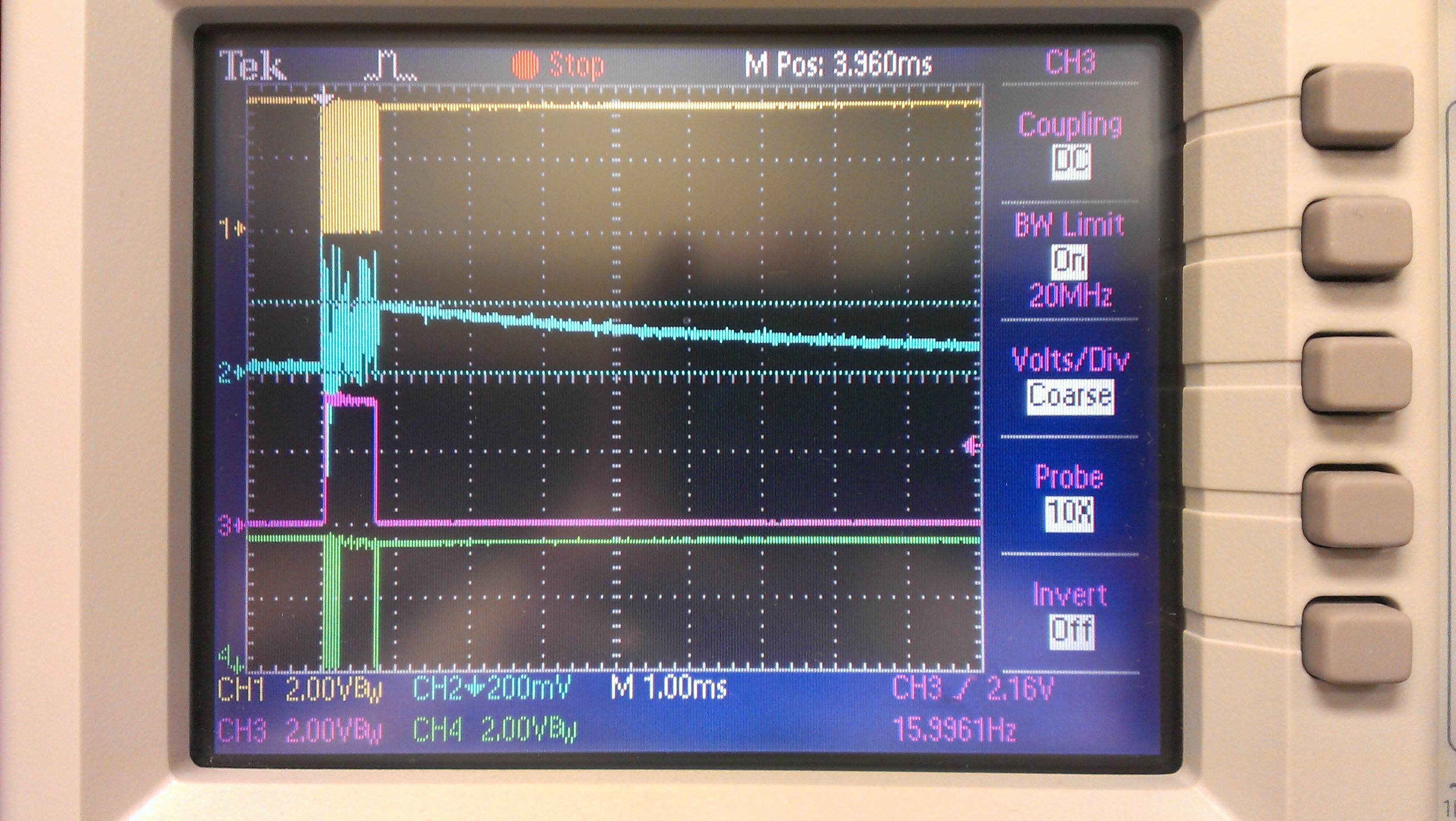

When I try to calculate the conversion time myself, I get 3.2 ms, which seems long. I would like someone to verify my calculations (no longer attached. Updated version in later post).
If SMCLK is used for the SD24_B, does this mean I cannot use LPM3 during the conversion time?
