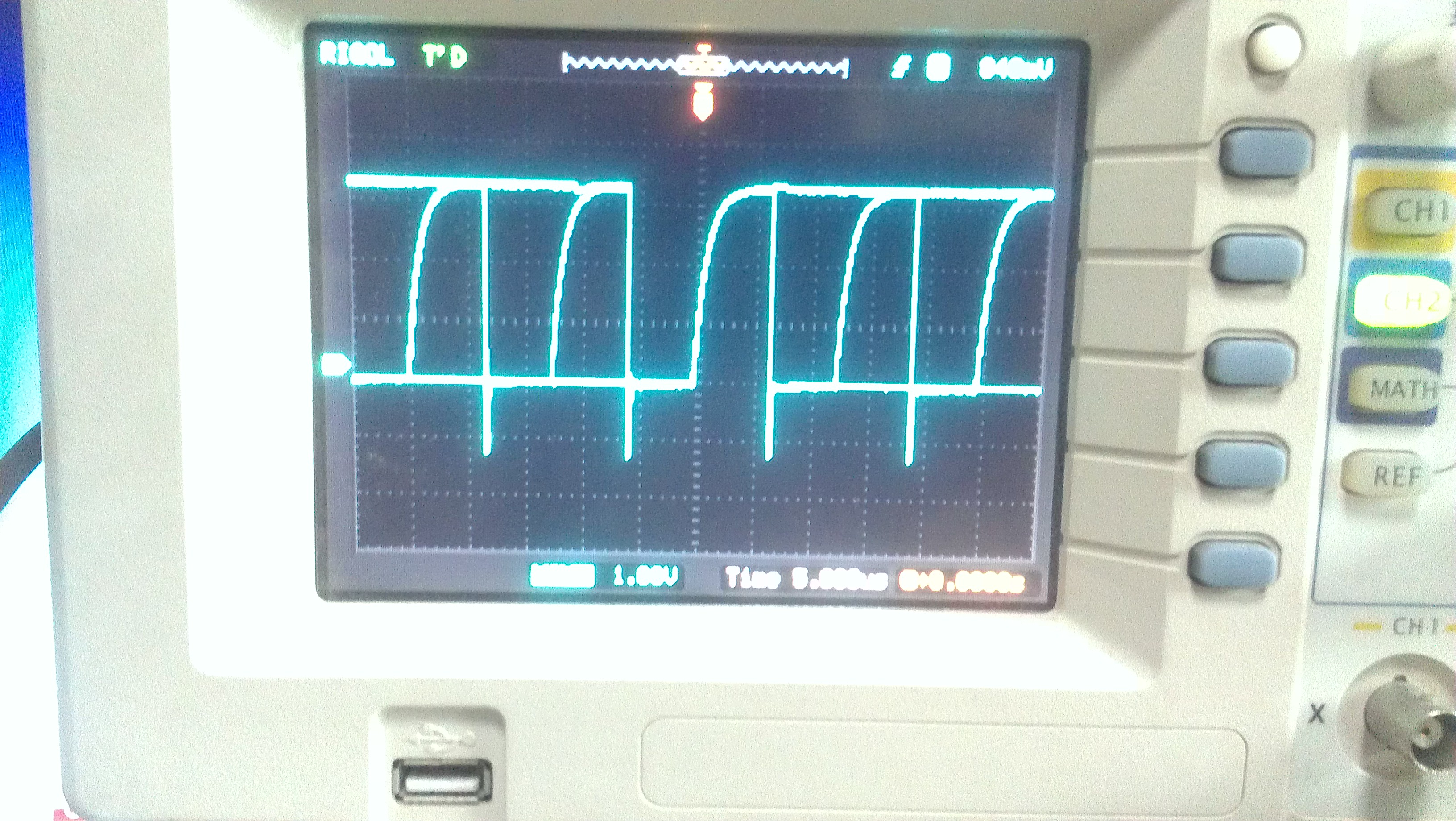

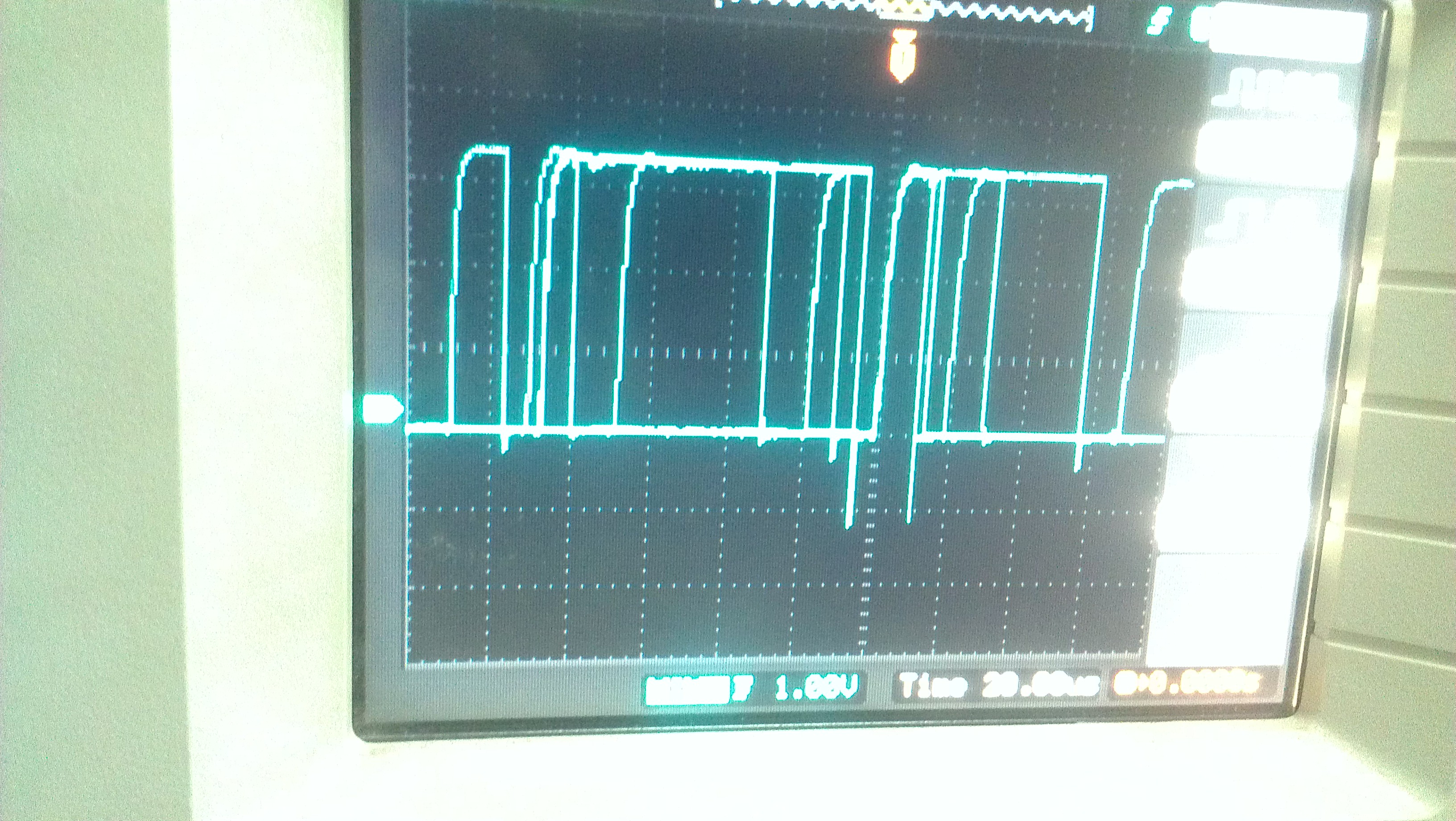

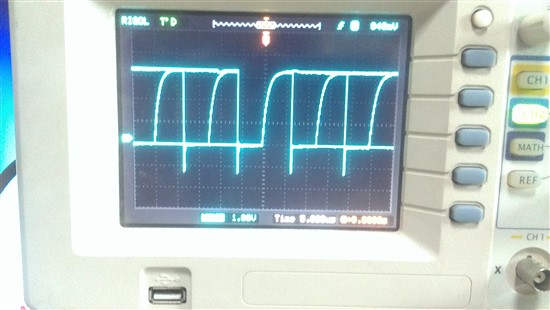

  • Thanks Jens-Michael for replying. I have taken some snapshots of oscilloscope to capture the SCL and SDA data. Upper and lower voltage level seems OK. I did not understand why there is ripple in the signal this may cause the the slave to not respond.
    Snapshot of SCL is
    Snapshot of SDA is given below
    I have checked all the connection which is looking OK. But I do not understand why there is noise in data. Is there anything which I am missing?
  • These 'undershoots' look strange. No idea where they come from.
    Also, the rising times of the signal are quite long. I'd suggest a stronger pullup resistor.
    The SDA line looks suspicious too. If the SCL clock pulses are so clean, the data lines should change their level in a similar timing and not so scattered. You should put both on one screen (with offset, so one on upper and one on lower half of the screen).
    You can set the trigger on the first falling edge of SDA (the start condition) and pick the timing so you will see the beginning of just one transfer (start byte and maybe first data byte). It makes the situation more clear.

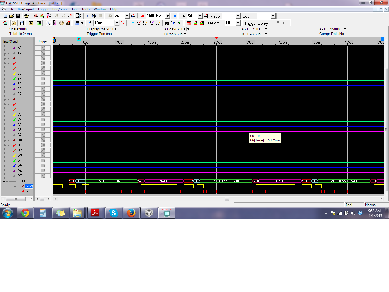

  • Thanks Jens for reply.
    "the rising times of the signal are quite long. I'd suggest a stronger pullup resistor"
    Yes it's true. rising time is quite long. I changed the pull up resistors 10K with 1K and now rising time is quite short.
    At-least I can get Ack from sensor first time but not after that. For example, after initialization of the I2C module, start condition is sent followed by the slave address. An Ack is received from the slave and command byte is sent by the master. when I again send the start condition with write bit to slave then it never respond and NACK is received by the master.
    I tried to start another transaction by initializing the I2C module. but could not get any ACK. I am trying to get a complete control on the sensor before reading the data from the sensor but could not succeed yet. Please find the code below
