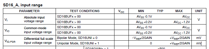

  • Michael Cushing said:
    *  Since the inputs are specified from -1 to AVcc, ground is nowhere close to a rail;
    *  We don't lose the negative half of the cycle, since the input can go down to -1 volt.
    Which msp430? Those chips with SD16 I know - does not allow what you say:
    *  I really don't think a low-pass filter at 60 MHz is going to fix anything;
    3dB @60MHz is still some attenuation on 1MHz. Note that 1LSB on 16 bit ADC is -96dB. I agree, it won't be much, but definitely more than nothing.
    Depends on the MSP you're using.
    Anyway, the MSP does not have a negative supply. GND is the 'negative rail'. Even though the electronics is built to circumvent this, there will still be nonlinearities or offsets around GND.

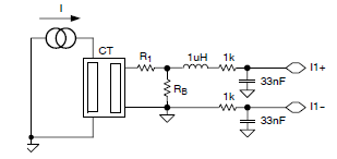

  • Ilmars,
    It's not really too special - if you look in the 4xx user's guide you will find one chapter on the SD16 and another chapter on the SD16-A.  Most of the energy chips are in the 2x family and they are called SD24 or SD24-A, but if you look at the specs they are just re-labeled SD16s (you CAN acquire 24 bits from all SD16s).
    The coupling circuit you show is just an anti-aliasing circuit (Fc = 4.8 kHz), except Rb is a burden resistor to match the output of the current transformer (CT) and the inductor is to reduce current spikes coming in from the power line.
    Thank you for explaining, but I was talking just about GND-connected secondary and series 1k resistor connecting "-" input which you found as an ultimate solution for your problem ;) Good luck, I am off of this funny thread

  • Well, my original question was, roughly, "What's wrong with SD16 single-ended inputs?"  We eventually concluded that it must be sensor common-mode noise, and sort-of closed the thread.
    It turns out that was wrong - the SD16, at least on the '42x, does handle single-ended inputs horribly.
    Searching for a better alternative, I ended up with the SD24 in the '67xx family.  On the surface, it looks like a re-branded SD16 - same SNR, etc.  In reality, it's a far superior device, and meets all of the goals.
    With the SD16 when I took the sensor and connected it differentially, I got a certain amount of noise.  When I switched it to single-ended mode, the noise increased by a factor of four.
    With the SD24 at a gain of four I get about 450 rms counts of noise (using a signed 25-bit sample) when the sensor is attached in either differential OR single-ended mode.  That 450 counts corresponds to 8 uV rms, which is pretty respectable even when compared with many analog ADCs.
    - Mike
    Surprising discovery! Thank you for letting us know. This once more reminds that if you are looking for performance - use standalone ADC.
