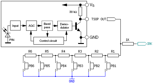

  • I am working on project for audio preamp control with MSP430x2xx. There is IR / KBD input on one (ADC) line with possibility of IR / KBD learning, and it will work (almost) wit any remote.
    Timer is in continuous up mode, and when IRK signal is changing (port interrupt), last up/down interval (calculated by difference in timer values) is stored. When all data are stored, command is decoded. If measured up / down interval is too long (timeout), than this is command begging / ending.
