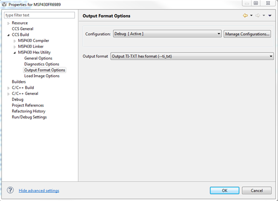

First, I have the CCSv6 (the latest, I downloaded it yesterday) and write my Code (at this moment, it's only a LED which should go on). I build my Code and get a out-file as resume.
Second, I use the Command Terminal from Windows to navigate in the folder where the out-file is (also the hex430.exe, i've copy them to this) and use this commandline:
hex430.exe -i name.out -o name.hex
Thirdly, i use the FlashPro430 vom Elpotronic (it's the Company I've the Programmer from) and want to do a "AtuoProg" with the hex-file. Evry time i get the resume "failed"
