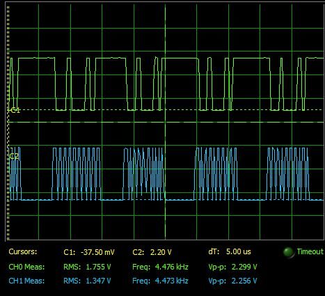

    But now I have another problem. The masterSendSingleByte() function never actually moves on to send the byte of data. It only sends the address. I have the code set up to repeat this function over and over again for testing purposes. I've attached a screenshot of the oscope screen. The slave address is 0010001. I can see the start condition is sent, then the address and then the 0 bit indicating a write to the slave but there is no acknowledge from the slave neither does the master send the actual data byte. Not sure why this is happening.

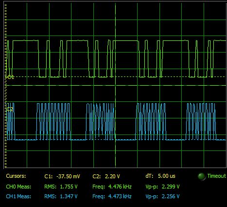

  •  Forgot to attach the Oscope screen, SDA is CH0 and SCL is CH1
  • User's Guide section 23.3.5.1.2 (I²C Slave Receiver Mode) says:
    If the slave receives data from the master, the eUSCI_B module is automatically configured as a receiver and UCTR is cleared. After the first data byte is received, the receive interrupt flag UCRXIFG0 is set. The eUSCI_B module automatically acknowledges the received data and can receive the next data byte.
    If the previous data was not read from the receive buffer UCBxRXBUF at the end of a reception, the bus is stalled by holding SCL low.
    Your slave is too lazy; I guess only the very first byte got ACKed.
  • Hi Brenton,
    I think Clemens is right here - If that is truly your whole slave code, then I don't see anywhere that your slave is ever reading out the received data - basically the I2C hardware thinks that your slave code is busy doing something else so it is stalling the line - the only way it knows you're ready to move on is by the code reading the buffer. I think you should either enable your receive interrupt in your slave code and read out the UCBxRXBUF in the ISR, or simply alter your while(1) loop to constantly poll for the receive flag to be set and then read out the data into a variable. The act of reading the data out will allow the I2C hardware state machine on the slave to progress and allow the communication to advance.
    Katie
  • Besides the said, your scope shoot looks suspicious. Your clock pulses are triangles rather than rectangles. With 100kHz clock speed, you should have nice, clean, steep rectangles, even (or especially) with the limited resolution of your scope. It's possible that the slave just can't decipher what it sees on the bus.
    Since falling and rising times are equal, it can't be just a too-small pull-up. It rather looks like a huge capacitance on the signal lines. Or your scope probe wreaks havoc on the signal (In which case I wouldn't trust anything I see on the screen).
