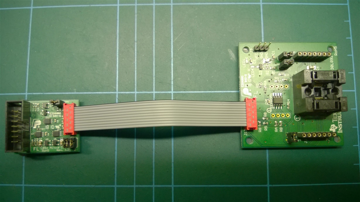

I have an L092 chip placed in my target board, which is in turn connected by the active cable to the MSP-FET, which is plugged into my PC. I know the chip and target board work (at least) since (as per the documentation), when the target board is powered the L092 loads the default blink program from the target board EEPROM, and blinks the onboard LEDs 3 times.
All I want to do is get started in programming it myself. I opened up CCS (6.1.0.00104), and created a new project targeting the L092 using the blink template. It builds fine, but when I try to upload (click debug) I get "MSP430: Error connecting to the target: Unknown device". I'm at a loss at what to try, since aside from solder the headers onto the target board, I haven't even done anything.
It may be worth mentioning that CCS told me that the MSP-FET needed a firmware update the first time I tried this. I let it run, and have had this problem since. I *believe* I have the newer MSP-FET as opposed to the old MSP-FET430UIF, but I wouldn't have thought that that would be a problem. This is all running under Windows 8.1. The MSP-FET shows up as two devices in device manager: MSP Application UART1 (COM3) and MSP Debug Interface (COM4).
Can someone tell me what is going wrong? If this is not going to work then I will be sending all of this straight back to TI for a refund.
