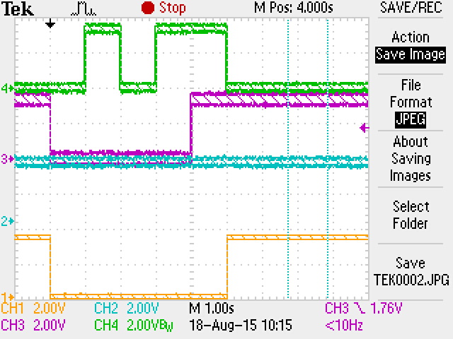

    Below is a screen shot of the BSL entry sequence. Trace 3 is the reset line and Trace 2 is the TEST pin. Trace 1 is the UART TX line.
    I have noticed that when I place a blank (new) device in the UART does not seem to be activated when I execute the BSL entry sequence and I cannot talk to the device. The only way I can talk to the BSL is to activate it from my application program.
    I am beginning to think that the device is not being erased when I issue the Mass Erase command and are thus unable to gain entry, but I still have no idea why I cannot activate BSL mode externally.
    Once the chip is programmed with my application code the UART is active but again the BSL entry sequence does not place the chip into BSL mode but my application program starts up after RESET goes high.

    To do this I had to change the timing of the RESET/TEST pin signals in order to enter BSL mode.
    Originally I uses these signals with about 10mS timing between the signals. After this did not work I tried going faster and using 25uS as shown above but this also did not work.
    I have now changed the timing so that these signals are 1 second between edges and now I have no problem with access to the BSL.
    The data sheet says that there must be a minimum of 250nS between these signals but I have never been any where near that close.
    Why do you think that I have to have such a long time between these signals?
    Below is my new timing:

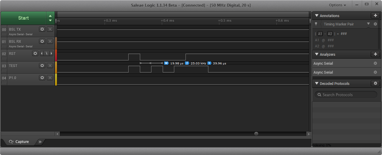

  • Hi Dave,
    I was able to replicate the behavior with my board. I tried the following sequence and it worked, though:
    The main difference was the initial toggle of both RST+TEST.
    I'll double-check this behavior with the team and file a bug if needed.
    I was also able to test some of the commands, but I didn't have any problems.

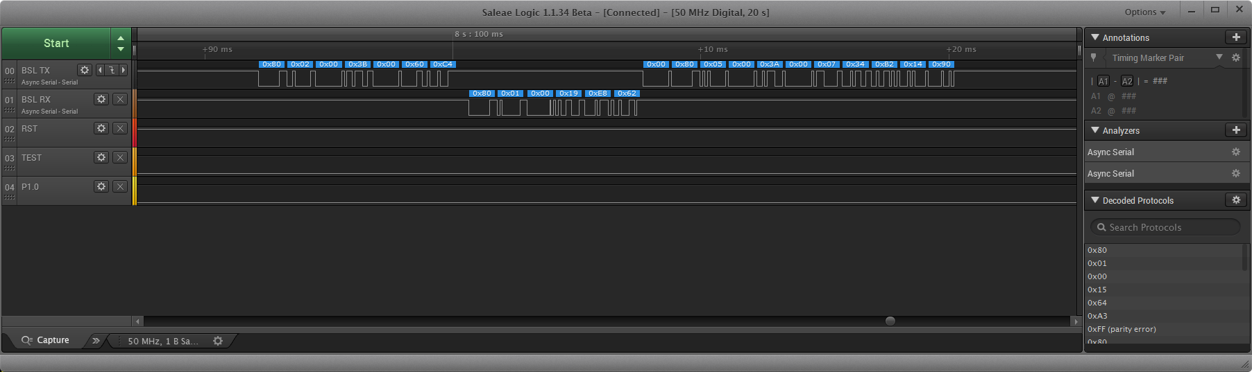

    Here's the mass erase:
    As you may already know, there's no response for Mass Erase. The device actually starts sending an ACK (0x00) but then it stops and the line goes high.
    Then I send the blank password:
    And here's the rest of the response to the password command, followed by the TX_Version command:

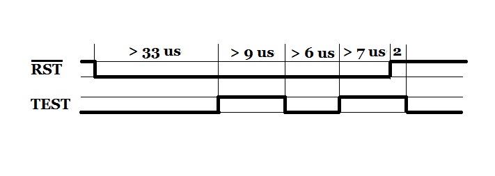

    While you are at it, I want to inform you that I found the timing requirements for MSP430FR6989 BSL entrance sequence are as follows:
    Michael Bolton39 tried this too. He says all those intervals have to be >69 us.
