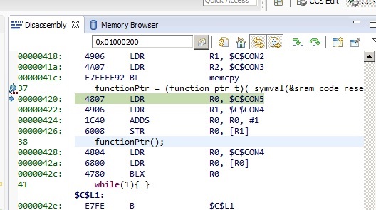

  • David, that code is causing my chip to continuously reset. I stepped through with assembly and it DOES seem jump the PC to 0x01000200 just as it goes kaboom.
    I have a few questions...
    First, why did you change the ".flashmailbox" from 0x00200000 to 0x00202000?
    Second, your assembly looks different than mine... For instance, at address 0x00000420, mine shows "4807     LDR             R0, $C$CON5" (functionPtr = (function_ptr_t)(_symval(&sram_code_reserved_run_start) + 1);), while yours shows "4806     ldr             r0, [pc, #0x18]" at a different address - 0x000007b6. Any idea why they are different? I copied and pasted your code, verbatim.......
    Here is a screenshot of the assembly leading up to the crash...
    Here is a screenshot of my SRAM just after it crashed.
  • Hi Philip,
     Sorry, I forgot to update my linker file, 0x00200000 should be ok.
    I'm attaching my project6471.msp432_sample_ram_project_ccs.zip, please unzip and import into your CCS workspace and let me know if you see the same behavior.
     David

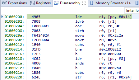

  • Ha! Yes, that works, David! However, I can't step through the C code for the SRAM function. I'm guessing that is because when I create a breakpoint in my C code inside the function that is copied to SRAM, the breakpoint is -actually- in the FLASH memory version of the function and NOT in the SRAM version? I can make a disassembly breakpoint at 0x01000200, though. I just wish there were some way to step through in C.
    Also, what happens when I call a FLASH function inside this SRAM function? When I try to do it, the faultISR gets called... This is bad news for my application. Any idea what is causing that?
  • Hi Philip,
     Glad to hear that it is working.
    Correct, that is the case.
    And we are working on adding this feature to our compiler/linker.
    The flash address copied into RAM is not being resolved correctly. Again, this will also be added to our compiler/linker.
