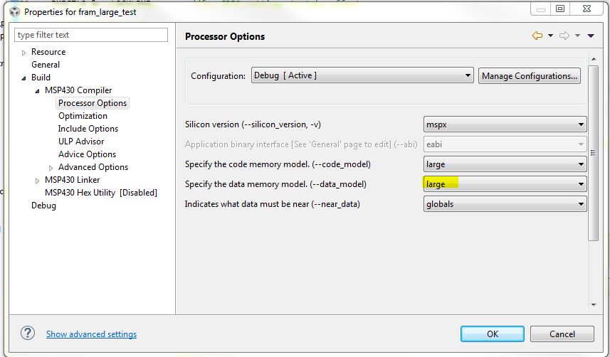

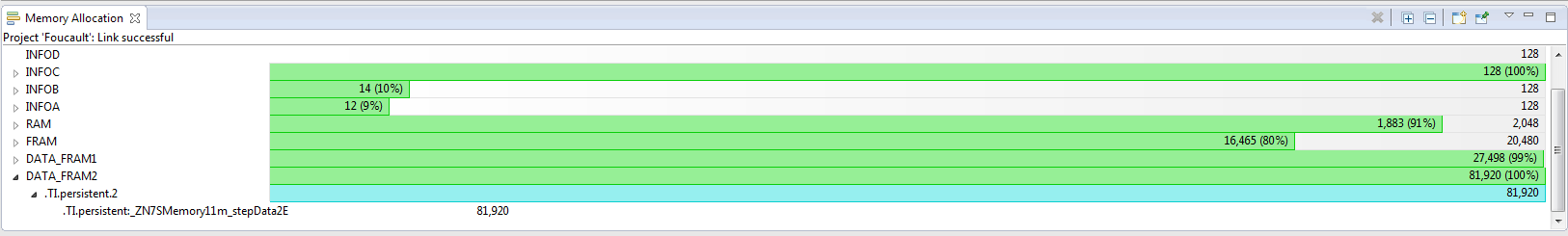

  • Hi Robert,
    Here is the solution that I came up with (I may have to split into a couple posts because there is a lot):
    I modified the linker file attached:https://e2e.ti.com/cfs-file/__key/communityserver-discussions-components-files/166/lnk_5F00_msp430fr6989_5F00_modified.cmd
    Note, I'm using a newer version of CCS (6.1.1.00022) than you I think because my linker file (version 1.180 in the comments at top of linker file) looked a little newer than yours to start with. You may want to make sure to check for updates to make sure this works the way I'm telling you....
    Assumptions that I made: that you don't need to use IP Encapsulation, but should still use the MPU to protect against errant writes.
    Here's a list of what I modified in the linker file/key features:
    1) MEMORY portion of linker file
        INFOD                   : origin = 0x1800, length = 0x0080
        //FRAM                    : origin = 0x4400, length = 0xBB80
        //NEW
        //need 0xA000 below 0x10000 boundary for our data
        //and needs to be AFTER FRAM for code (for MPU grouping)
        //also need 0x400 boundary (granularity of MPU) so have to
        //add a little to DATA_FRAM to accomodate this
        FRAM                    : origin = 0x4400, length = 0x1800
        DATA_FRAM				: origin = 0x5C00, length = 0xA380
        //END NEW
        FRAM2                   : origin = 0x10000,length = 0x14000

    3) You need to set a few project properties to support the way we are using memory.
    MPU setup:
    Go to Project > Properties > General. There is an MSP430 MPU tab. By default, it will have "Enable Memory Protection Unit (MPU)" checked, and the radio button set to "Let compiler handle memory partitioning, associated access rights, and linker output section placemant". Leave it this way - this will make sure you have the MPU being used. All the changes we made in the linker file before will allow us to simply use this default setting. If we hadn't done some of the changes with the #defines for MPU at the end of the linker file, you'd end up having to select to manually specify the memory segments here instead and set everything correctly (that is another option, but as long as we were having to change the linker file I figured it would be best to just do it all there anyway).
    large data/memory model:
    In Project > Properties > MSP430 Compiler > Processor Options, select it as shown below:
    By default, it was probably set to large code model but restricted data model. I changed it to large data model since we are going to be writing to the 20-bit space for our data.
    Click OK after setting all of these and build the project.

  • Katie,
    Thank you so much for such a detailed and helpful response! I don't think I've ever received such a helpful response as this one. I do have one question. I may end up changing the amount of memory reserved for data storage, but I went ahead and tried compiling with the ranges you had outlined in your example.
    The problem I run into is if I allocate my two data buffers as you had done in your c file (one at 0x14000, and the other at 0xA000), I get errors saying that the code is too large to fit into memory. If, however, I subtract 0x400 from 0xA000 (0x9F80) and use that, it uses up every last bit of memory in DATA_FRAM:
    #define STEP_DATA_BUF_1_SIZE_BYTES  0x9F80
    #define STEP_DATA_BUF_2_SIZE_BYTES  0x14000
    #pragma PERSISTENT
    uint8_t SMemory::m_stepData1[STEP_DATA_BUF_1_SIZE_BYTES] = {0};
    #pragma PERSISTENT
    uint8_t SMemory::m_stepData2[STEP_DATA_BUF_2_SIZE_BYTES] = {0};
    My question is, what is using that extra 0x400 bytes? When I look at the memory allocation gui, there's nothing in there taking up those 0x400 bytes. My only thought is that I am using C++ and perhaps that is a factor?
    Let me know what you think and thanks again!

    Does your code use stdio.h, like printf? If so, then this .cio section would be getting initialized and taking up some space. If you look in your Debug folder, open the .map file and do a search for .cio and for .sysmem. For me, as soon as I added #include <stdio.h> and a printf() statement to my project I started seeing the same issue you did, with 0x400 bytes not fitting. For me, my map file showed:
    .cio       0    00005c00    00000120     UNINITIALIZED
                      00005c00    00000120     rts430x_lc_ld_eabi.lib : trgmsg.obj (.cio)
    .sysmem    0    00005d20    000000a0     UNINITIALIZED
                      00005d20    00000008     rts430x_lc_ld_eabi.lib : memory.obj (.sysmem)
                      00005d28    00000098     --HOLE--
    You can see that .cio is placed at the beginning of DATA_FRAM - it needs to be, because it of course needs to be read-write memory. It is taking up 0x120 bytes for this buffer for the printf support. In addition, you can see that it also added space to .sysmem 0xA0 bytes = 160 bytes. This is the heap - you can find in Project > properties > MSP430 Linker > Basic options the heap size is 160 for dynamic memory allocation.
    So in your project, check your map file for these two sections (.cio and .sysmem), and adjust your linker file size accordingly. Or don't use printf if you don't have to (we usually recommend avoiding stdio functions in general because they take up a lot of space and resources, which you can usually do more efficiently for an embedded app like this).
    Now, the reason that an entire 0x400 bytes is being added is because you can see that the linker file is set to the the READ_WRITE_MEMORY start at a section aligned to 0x400 - this was because we need to make sure whatever address we use for the start of DATA_FRAM, it needs to be aligned to a 0x400 byte boundary for the MPU border-setting to work out correctly. You could take out this PALIGN 0x400, but just need to make sure when you define DATA_FRAM manually that you align it to a 0x400 byte boundary.
    So 3 different options to get around this, depending on your situation:
    1) make DATA_FRAM 0x400 bytes longer when you define it at the top of the linker file
    OR
    2) don't use stdio functions
    OR
    3) place .cio and .sysmem in RAM instead of FRAM (assuming you are having enough extra RAM in your application?) You can do this by changing the linker file - move .cio and .sysmem outside of the GROUP(READ_WRITE_MEMORY) and set them to go into RAM instead:
               //.TI.persistent : {}              /* For #pragma persistent            */
              // .cio           : {}              /* C I/O Buffer                      */
               //.sysmem        : {}              /* Dynamic memory allocation area    */
            } PALIGN(0x0400) > DATA_FRAM, RUN_START(fram_rw_start) RUN_START(fram_rx_end)
               .cio           : {}    > RAM          /* C I/O Buffer                      */
               .sysmem        : {}    > RAM          /* Dynamic memory allocation area    */
    If you do option 3, then for sure the only things in DATA_FRAM are things you defined as PERSISTENT.
    Katie

  • Hi Cassandra,
    I'm glad you found my post helpful.
    My first question is - do you have a specific reason that you need to control the addresses of where the FRAM variables are placed? They are not very long, so I'm wondering why not just let them go in the default setup/placement for PERSISTENT, where it will place them wherever it has space in the lower FRAM? You indicated you only need about 12 bytes so this is why I was wondering about the need to put them in the upper FRAM.
    If you don't have some specific reason to place them at specific addresses, I'd recommend returning to the default linker file for this device with no modifications, and simply declaring your variables with the #pragma PERSISTENT.
    Katie
  • Thanks for your quick response!
    The reason why we are wanting to have this control is that when we are turning the power off from our project we want to save three specific variables in order to obtain our count of where we left off. So when we put in the new battery, I can just declare these variables with the existing data. That would make it a lot easier than having to manipulate the whole FRAM segment and piecing out which one was variable A, B, and C.
    My understanding is if we use #pragma PERSISTENT we would need to write it all at once. That means I would need to get my three variables into one segment and then declare it the PERSISTENT. That means I would need to factor in all the shifting of the lower FRAM. I would want to shift the variable A all the way to the MSB of the lower FRAM memory location by 4 byes, then shift variable B into the next lower FRAM memory with 4 bytes reserved, and then variable C into the next 4 bytes, and then leave the rest as 0s.
    If you feel that this is a better way to do it, then could you provide an example of doing something of this sort? Also, I merged your linker file into our project and I get a memory issue with our program not being able to fit - so I guess that this exactly won't work with what we need.

  • Great! I'm so glad you got it working. I was wondering - would you have any feedback on the documentation about the PERSISTENT pragma that we could do to help make it clearer that you can have more than one PERSISTENT variable?
    -Katie
  • Thanks Katie,
    I am using MSP430FR6989 launchpad, these modifications in linker file helped me to store data in FRAM.
