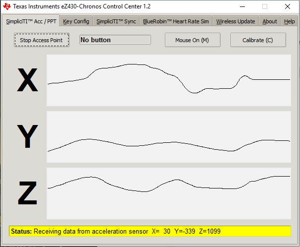

  • Hi All,
    Tested the whole chain from code generation (CCS) up to firmware upload and checking with ezChronos control center
  • I don't have this warning, but I'll try disabling driver signature tonight. Now I'm studying for a digital control of dynamic systems exam I'll have Tuesday... hobbies before responsibilities (aren't they the same? ....) Thanks for your help!
  • It works. That is were the "mystical error" was with drivers installation!
    Thanks for your help, now let's play with it:
