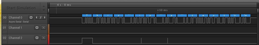

    This is what I saw on my logic analyzer: (viewer available here: http://downloads.saleae.com/betas/1.2.5/Logic+Setup+1.2.5.exe ) Data from logic analyzer:https://e2e.ti.com/cfs-file/__key/communityserver-discussions-components-files/166/Uart_5F00_test.logicdata
    Screenshot of a portion of it:
    Channel 0 is TXD, Channel 1 is RXD, Channel 2 is P3.0. As you can see, P3.0 is actually cleared right after the first byte, indicating that you entered the ISR for the UCTXCPTIFG right after the first byte. Is that the same thing you were seeing?

    Interesting bug! I am able to reproduce it.
    The picture shows TX, The time spent in TXIFG (while pulse is high), and the time spent in TXCPT. I'm not able to observe a case where the TXCPTIFG flag is not asserted.
    I'll get with the systems team and report back.
    Cameron
