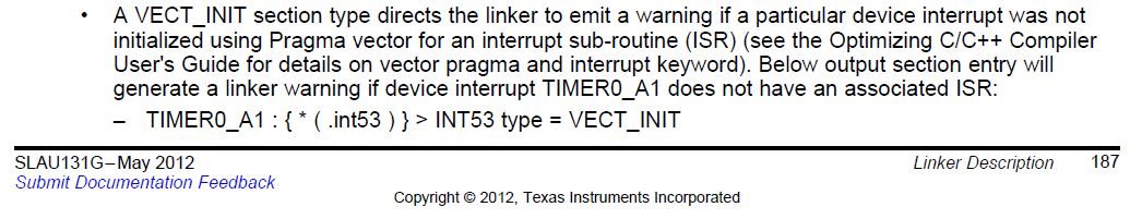

It is described as follows in the SLAU131G(187page).
But the warning is not output, even if interrupt wasn't initialized using Pragma vector.
(I used CCSv6.1 : Compiler version TI v4.4.6)
Why isn't the warning output ?
Isn't this define("type = VECT_INIT") necessary ?

    A VECT_INIT section type will generate a linker warning if the peripheral does not have an associated ISR and is not using the default ISR.  This is further explained in the newest release of SLAU131(K):
    The difference you are missing is the default vector handler now provided by the run-time support (RTS) library.  The warning will therefore not be output if a vector pragma for the ISR is initialized or if the default vector handler is provided by the RTS library.
    Regards, Ryan

    In other words, it is no problem that I don't write "type = VECT_INIT" ?
    Mino.M
  • Hi Mino,
    That is correct, the linker command file has been designed such that you shouldn't have to make changes to the initialization of interrupt vectors.
