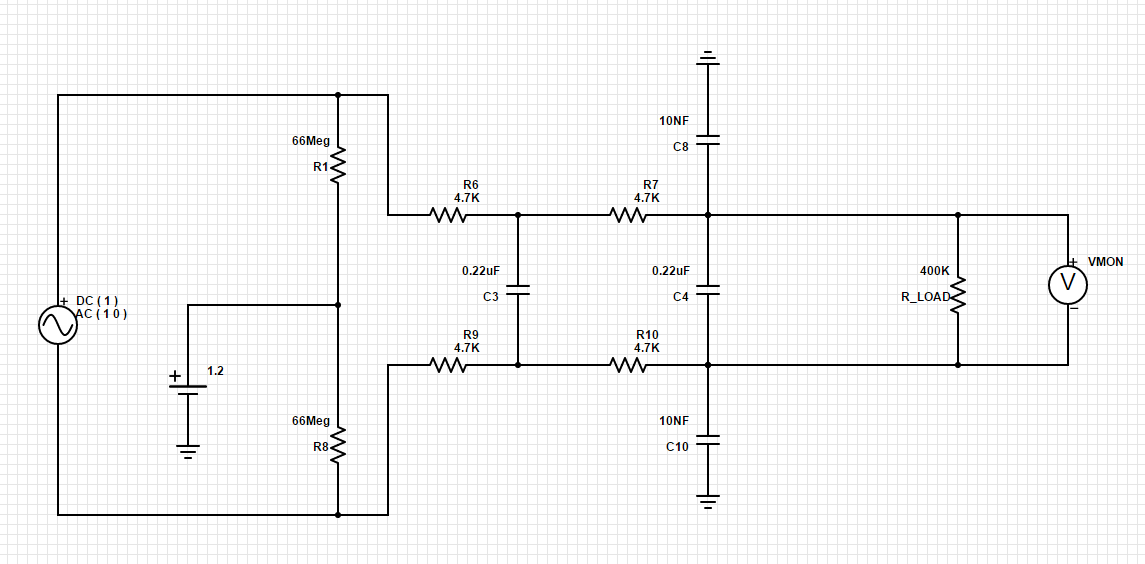

Our application acquires very low frequency physiological signals (<1Hz)
From the transducer the signal is being LPF -ed (2-pole differential RC filter) and then fed into AIN0 differential input of SD24.
We have noticed that at very low frequencies there is attenuation in the ADC readout that apparently form some sort of HPF/BPF.
What can be the source of this low freq attenuation? Is there any sort of serial capacitance (switched caps ?)
The datasheet only mentions 200Kohm input impedance (400KOhm differential).
How can  it be mitigated ?
Thanks in advance for any advice.

    We did the following experiment - Replaced the transducer with AC signal generator and applied sine wave at various frequencies.
    Using oscilloscope, we have measured the output amplitude on AIN0P-AIN0N input with and WITHOUT MSP430i2041 installed :

    The model of the HW is attached. The rightmost resistor represents the MSP430i2041 AIN0 input:
    The DC source is actually buffered Vref (internal source) that is applied to the transducer in order to bias it on the positive rail.
    As can be seen from the table there is a substantial attenuation in lower freqs when the MCU is mounted.
    Any thoughts ?

  • Please confirm that you use external reference. It could be leakage that leads to clipping. I would test using stronger "virtual ground" resistors: instead of using 2x 66MOhm, I would test with 2x 10KOhm and signal from generator. If 2x 10K gives expected results then you have starting point to investigate further.

    Did you try phenomena using lower resistance of virtual ground resistors? - 10KOhm instead of 66MOhm?
