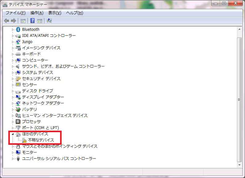

  • Thanks again Kaka. Sorry for another question, but I am trying to include some other persons as this seems to be common to the F5529LP also. Can you see any device in the device manager when the 5529LP or the CapTIvate tool is plugged in? IE do you see either the debugger or the application UART or are both missing.
    Chris
  • Hi Chirs,
    I captured the device manager as below. Please see as follow. I could not see either the debugger and application UART. PC showed this board as "Unknown device".

    > I failed to ask previously when looking for the application uart and debugger (CDC class), was the HID seen?
    I could not see the any classes likes CDC, HID on USB function.

  • Hi Chirs,
    I have a update for this topic.
    My PC could recognize this boards (including MSP-EXP5539LP) by re-installing the USB3.0 driver for PC.
    Thank you for your kindly supports.
