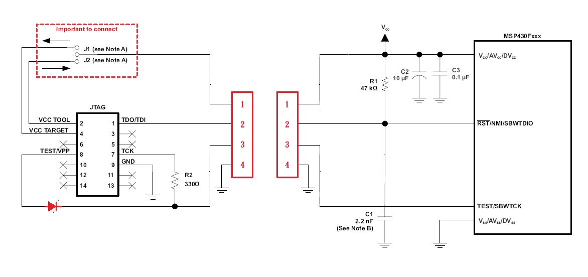

Hi all,
I've searched the forum and half of the web but couldn't find a
reliable(!) answer...

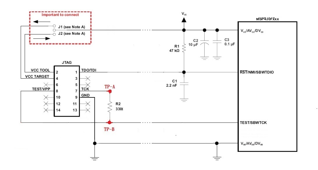

An F4152 is going to be used. As far as I understood things
correctly (reading slau320v), the Spy-Bi-Wire interface has the
same functionality as the "normal" 4 wire interface, just being
slower.
In order to protect the software, the JTAG fuse has to be blown.
This can only be done by the JTAG itself.
Since I do not intend to use the JTAG interface by any other
means, I would like to free up the 4 pins which would be used
for the 4 wire interface and blow the fuse through SBW.

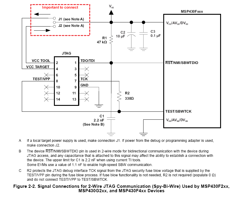

Judging from slau320v, this should be possible. One thing is
that the SBW interface has to be implemented correctly including
the connection from TEST/VPP to the CPU and by protecting the
TCK with 330 Ohms (see page 23 of slau278x).
Have people verified this to work?
Is it possible with the standard MSP-FET or MSP-FET430UIF?
Is it working reliably?
Thanks and regards!

  • Thanks for the answer. Hmm, I am new to all this stuff but if I get page 9 of slau320
    correctly, TCK only goes from JTAG to CPU. So how about using some Low Vf Shottky
    diode (e.g. BAT 60A) instead of the 330 ohms -- maybe together with an additional
    pull-down resistor?
    For me, reliability of this process is not that important but once the stuff gets handed
    over to the final manufacturer of the device, it has to work...
    As you emphasised the MSP-FET: Are there other interfaces which maybe work more
    reliably?
    Another option would be to blow the fuse before the CPU will be soldered (by using
    the 4 wire interface) but this will cost additional time and is error prone.
    Best would be if one could order it with the fuse already blown, so all this wouldn't
    be needed...

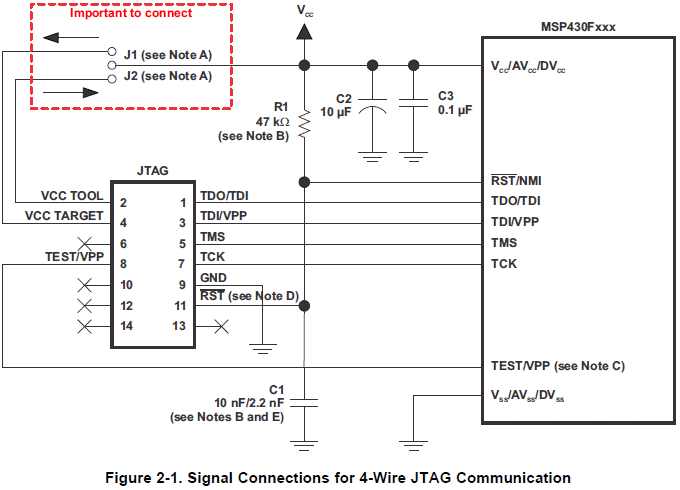

  • For SBW, your device has TEST pin, and doesn't need to "combine" it with TCK. This, what you are writing about is related to devices without TEST pin.  For SBW fuse blow, you don't need any extra resistor anywhere. It is same with FET430UIF or MSP-FET.
    If you don't want to use Windows, there is TI open source MSP Flasher that is working also on Linux / OS X.
    http://www.ti.com/tool/msp430-flasher
  • Maybe I haven't understood the whole SBW concept... The TEST/SBWTCK pin has IMHO two purposes: 1. Being the clock pin for the SBW interface and receiving the voltage for the fuse blow. This is why it is "combined" (as I call it ) by using the 330 ohms resistor here:
  • From my point of view, this picture from slau278 has correct connection for your device, for SBW (VPP on TEST pin) and JTAG (VPP on TDI pin), regarding communication and fuse blow. However, it is marked as for JTAG communication, not for SBW, so somebody from TI should clarify this.
  • > picture from slau278 has correct connection for your device, for SBW (VPP on TEST pin) and JTAG (VPP on TDI pin),
    No, not for SBW in my eyes. It's just for (4-wire) JTAG. The connection TEST/VPP is just for setting up the 4-wire JTAG.
    Unfortunateley, I cut away the footer of my pic, let's try again ;-)
    Here TEST/VPP is used to set up SBW communication (TEST) and to pass the fuse blowing voltage (VPP). However, for communicating with the device (once it has been set up) TCK is used. But both end on the same pin TEST/SBWTCK and this is why they have to be "combined" with the 330 ohms resistor.
    This is my "newbie" interpretation of things but it is quite possible that I still haven't got it correctly ;-)

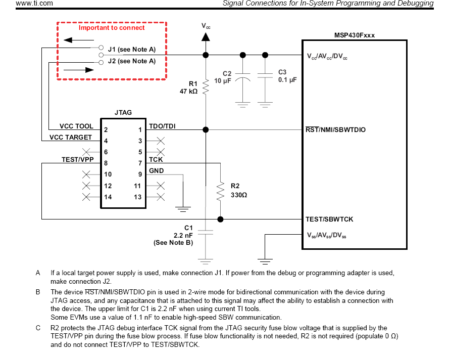

    Almost correct, but read the foot note C of that Figure. The TCK pin of the FET-MSP is used to drive the SBWTCK of the target to set up SBW communication etc.. But it cannot deliver the final blow (a 6V pulse of 1 msec in duration). The TEST/VPP pin of the FET-MSP is used for that 1 msec only.

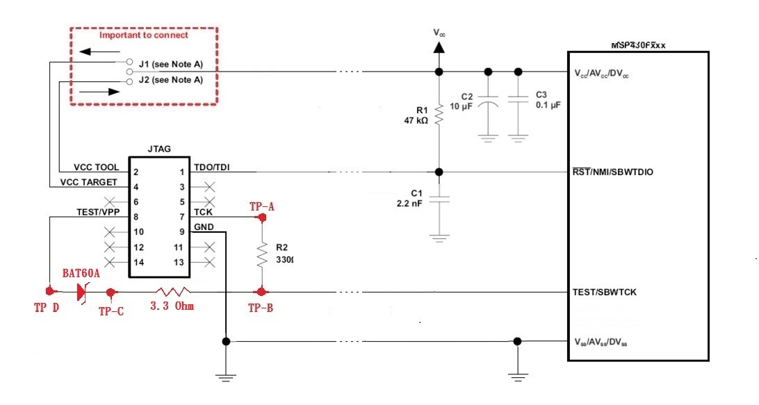

    Tom Dehler said:
    So how about using some Low Vf Shottky diode (e.g. BAT 60A) instead of the 330 ohms ...
    Good idea, that might work. The TEST/VPP pin of the FET-MSP is probably driven low (instead of being in a high-impedance neutral state0
  • > The TCK pin of the FET-MSP is used to drive the SBWTCK of the target to set up SBW
    Ah, right, I mixed this up. So we can say: All "normal" SBW communication (setup and subsequent usage) is done by TCK, only the fuse-blowing voltage comes from TEST/VPP.
    If it's driven low actively we need another diode coming from TEST/VPP. But this won't be a problem since these additional 0,2 V probably can be generated within the FET. And we might need some pulldown on the TEST/SBWCTK side to get well-defined conditions there. OK, these would be 3 additional parts instead of just a 330 ohms but it's probably a cleaner approach. If lines are kept short, it might even be placed within the FET so it won't be needed on every target board...
  • Almost. I thought of something like this:
  • That may be better.
    Could you or someone test this scheme? If so, I can make suggestions to get to the bottom of this. I do not the stuff needed to do it myself.

  • FET VPP is 6.5V, and minimum voltage for fuse blowing in datasheet is 6V. Maybe VPP with diode voltage drop will not be high enough for fuse blow.

  • > Maybe VPP with diode voltage drop will not be high enough for fuse blow.
    The BAT60A should be OK for that. Vf should be < 0.2V @100mA. Ir is less than 1mA @6.5V

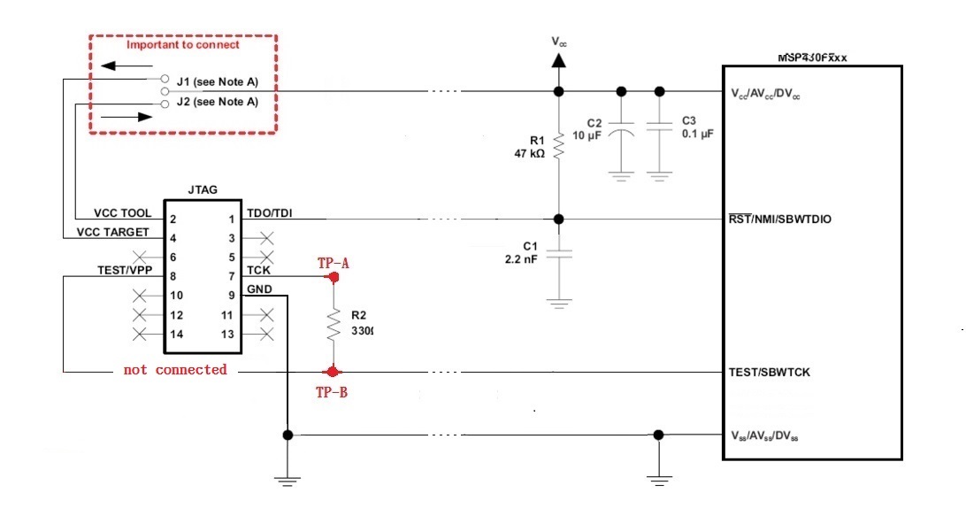

  • Tom Dehler said:
     ... I plan to investigate flashing / fusing as soon as possible...
    Here is a plan to test the scheme.
    Step #1.
    Connect MSP-FET and the target as shown below.
    Please make the length of the 4 wires between the MSP-FET and the target short but practically possible for field use. Also bundle 4 wires the same way you would for field use.
    Note that MSP-FET pin 8 TEST/VPP is not connected to anything.
    Even without TEST/VPP connected, you should be able to use all the SBW operations except blowing the FUSE. Try a few of them (but not blowing the FUSE) and use an oscilloscope to examine the wave-forms at TP-A and TP-B. The wave-forms should be almost identical. Specifically, they normally should both high and very near Vcc. When they go low, they should be very near Vss. The frequency can be ~1 MHz (depends on the SBW software/firmware). The rise/fall time of the wave-forms should be fast enough at such frequency and beyond.
    Step #2.
    In this step, you add the connection from MSP-FET pin 8 TEST/VPP to TP-B as shown below.
    Again, try a few of SBW operations (but not blowing the FUSE) and use the oscilloscope to examine the wave-forms at TP-A and TP-B the same way as in Step #1 This time, you may find TP-B quite different and the SBW operation may not work or working not reliably. Specifically, I worry about the high level of TP-B not being close enough to Vcc.
    Step #3
    We modify the connections again to include a BAT60A diode and a 3.3 Ohm resister. The resistor is not going to the final design. It is included during Step #4 to verify that (a) we still have margin for enough FUSE blowing voltage and (b) to act as a current probe to tell if and when the FUSE is blown.
    But during Step #3, we still do not try to blow the FUSE. We will repeat as in Step #1 & #2 to compare wave-forms of TP-A and TP-B.
    Step #4.
    I think we should review the results of Step #1, #2, and #3 before we actually try to blow the FUSE as we only get one chance per target chip to do so.

  • > Here is a plan to test the scheme.
    I do not quite understand what you try to accomplish by adding the diode to the TEST/VPP wire. This way TEST/VPP is protected from TCK going high. But this was never an issue. TI added the 330 ohms in order to protect TCK from the 6.5V on TEST/VPP during fuse blowing. My intention was to replace the 330 ohms by the diode so we get known voltages on TEST/SBWTCK and no (or almost no) feedback to TCK while blowing the fuse. As I don't know what TEST/VPP does during "normal" SBW communications I suggested an additional diode there. It is probably unneeded since I expect TEST/VPP to be High-Z when not used (otherwise TI's version wouldn't work). My additional pull-down resistor is probably unneded since the device has an internal one.
    But if I decide to go the FR4133 path, all this is unneeded, fortunately ;-)
