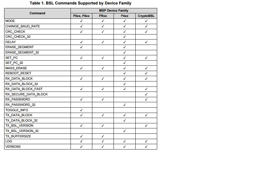

  • Hi Dirk,
    I'm not sure what those commands are since according to the BSL user's guide, these commands are unlisted. Section 2.1 of the user's guide has explanations for the MODE command which initializes the selected communication channel for a BSL session and invokes the BSL. Example commands are included which initializes UART and the BAUD Rate for MSP432.
    http://www.ti.com/lit/ug/slau655/slau655.pdf
    Sincerely,
    Sean
