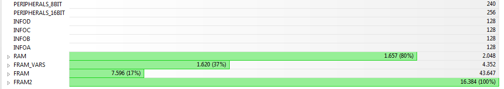

Good day everyone!
I am facing a problem here which I am unsure on which keywords I need to search for.
Heres what I have:
MSP430FR5949 + wireless module + custom wireless protocol
Program size < 50% memory
CCS 6.0.1
What I want to do:
Final goal is a wireless firmware update.
Steps:
1) Generate a hex file, as small as possible but with everything I need
2) Transfer the file in small blocks to the MCU and store it in FRAM (including CRCs etc. to make sure everything is correct)
3) Set a Flag in FRAM that a new firmware is availible and reset the MCU
4) Let the MCU copy the new firmware into the correct memory areas
Point 2) and 3) are simple and almost done. My problems currently are Step 1) und and Step 4) How can I achieve this? What would I need to pay attention to? What are good keywords to goole for?
Heres my current memory map. Will I have to copy the whole RAM section as well?
Any help is appreciated.
Kind regards,
Tim
  • Hello Tim,
    TI is planning to release OTA solutions for MSP30 FRAM devices by the end of this year. But for now, the best solution offered is the OTA Update With the MSP430FR57xx App Report (SLAA511): www.ti.com/.../slaa511a.pdf
    You will probably find the MSPBoot App Report (SLAA600) useful regarding how to create a bootloader that resides in main memory: www.ti.com.cn/.../slaa600a.pdf
    Ryan

  • Hi!
    I would just like to post a short follow up. The code is running now, everything working. The linked projects and documentation helped a lot and were basically everything I needed.
    Regarding my last question: I just manually copied the two ti-txt files into one image which is working fine.
    Thanks for all your help Ryan!
