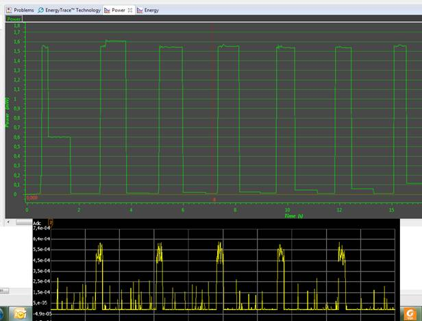

    I've got some progress, I can now mesure low consumption in sleep mode using.
    - Using CCSV6.1.3
    - As required "no debugging" active
    - And to avoid any unwanted consumption on my JTAG connexion, I've only connected VCC and GND from the MS-FET JTAG
    But I still have a strange behavior.
    Consumption is not really the same that the one measured by an "Current meter" positionned between my VCC and my device. (See image joined). If anyone have an idea to explane that ?
  • Bandwidth of your currentmeter is much higher than EnergyTrace. In other words - EnergyTrace averages measurements. After all it is never advertised as precision instrument.
  • One thing that seems to be affecting your results is a known bug in the plotting of the power graph in CCS' EnergyTrace display: https://e2e.ti.com/support/development_tools/code_composer_studio/f/81/p/448872/1621699#1621699
  • Oh yes,
    You seem to be right ... same behavior.
    I'll soon make new measure to verify.
    How can we know if bug is known, traced and will be corrected ?
  • Later in that thread a TI employee confirms that they've repro'd the issue and found the root cause. I don't know what the timescale is for fixing it; the best thing I can suggest is that you post to that thread and ask for an update from TI.
