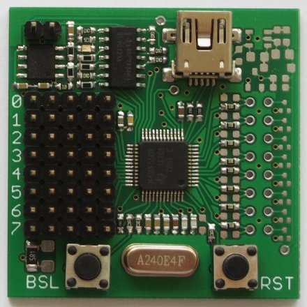

    SBW should have same length of CLK / DATA (TEST / RESET) lines. Problem for SBW is cap on RESET pin. I tested SBW without cap on RESET pin (5xx flash target device) with direct connection from master (pins) over 1 m length ribbon cable (without drivers / termination) on 6 MHz (200 KByte/s write / verify). It was working just fine on 1.8V and 3.3V.

    My SBW+ (MSP-GANG like) programmer is faster than MSP-GANG, and without cap on target device RESET pin it can write up to 48 KByte/s on 2xx and 200 KByte/s on 5xx. Connection between master and target devices can be longer than 50 cm. With 1 nF cap on target RESET pin it is limited to slow mode (still faster than MSP-GANG). It is without fuse blow option for 2xx.
    http://forum.43oh.com/topic/2972-sbw-msp430f550x-based-programmer/?p=48762
