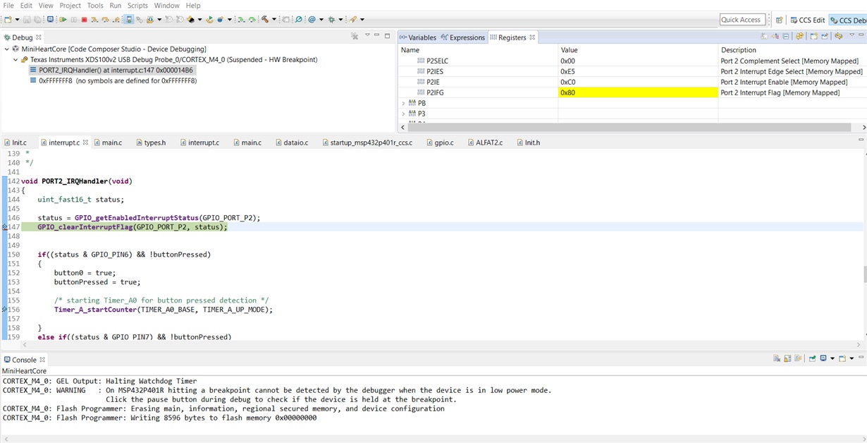

  • OK. Right now I am really troubled!
    I tried to update my code and implementing a button debounce as long with a different approach on using the Timer for checking if a button has been pressed, but now the MSP432 behaves really strange: I didn't really change some basic ISR handling, just added new features, but now, when the PORT2 gets an interrupt from the falling edge and treis to check which of the enabled interrupt flags is set, it allways reads zero in my status variable. So as if there wasn't recognized which pin of PORT2 triggered the interrupt. Really strange. Also when I check the register values there sometimes seems to be no recognition of the initiated interrupt through P2.6.
    What dark sorcery is this? I will try to factory reset the MSP432 and try again. Here's my new code, maybee there is something wrong here, but i don't think so, since the MSP's behaviour isn't allways the same,..
     * \brief	PORT2 ISR
     * \author 	Benjamin Brammer
     * \date   	15.07.16
     * This interrupt is triggered if BUTTON0_MSP432 or
     * BUTTON1_MSP432 is pressed. It either starts the button-pressed
     * detection routine via Timer_A0 or just sets an event marker.
     * IMPORTANT!! pressing BUTTON0_MSP432 and BUTTON1_MSP432 simultaneously
     * will result in erroneous behaviour since in both cases Timer_A0 is used
     * to debounce button pressing!
    void PORT2_IRQHandler(void)
        uint_fast16_t status;
        status = GPIO_getEnabledInterruptStatus(GPIO_PORT_P2);
        GPIO_clearInterruptFlag(GPIO_PORT_P2, status);
        if((status & GPIO_PIN6) && !buttonPressed)
        	button0 = true;
        	buttonPressed = true;
        	/* starting Timer_A0 for button pressed detection */
        	Timer_A_startCounter(TIMER_A0_BASE, TIMER_A_UP_MODE);
        else if((status & GPIO_PIN7) && !buttonPressed)
    and here the Timer ISR:
     * \brief	Timer_A0_CapComp ISR
     * \date   	27.07.16
     * This interrupt checks if a correct button press has
     * been detected.
    void TA0_N_IRQHandler(void)
    	/* halting the timer */
    	Timer_A_stopTimer(TIMER_A0_BASE);
    	if(button0)
    		if (measureState == IDLE && !GPIO_getInputPinValue(GPIO_PORT_P2
    		, GPIO_PIN6))
    			  measureState = INIT;
    			  BOARD_LED_MEASURE_START_ON;
    			else if (measureState == ACTIVE && !GPIO_getInputPinValue(GPIO_PORT_P2
    					, GPIO_PIN6))
    				BOARD_LED_MEASURE_STOP_ON;
    				measureState = FINISH;
    			else if (measureState == FINISH && !GPIO_getInputPinValue(GPIO_PORT_P2
    					, GPIO_PIN6))
    		buttonPressed = false;
    		button0 = false;
    	else if(!GPIO_getInputPinValue(GPIO_PORT_P2
    			, GPIO_PIN7))

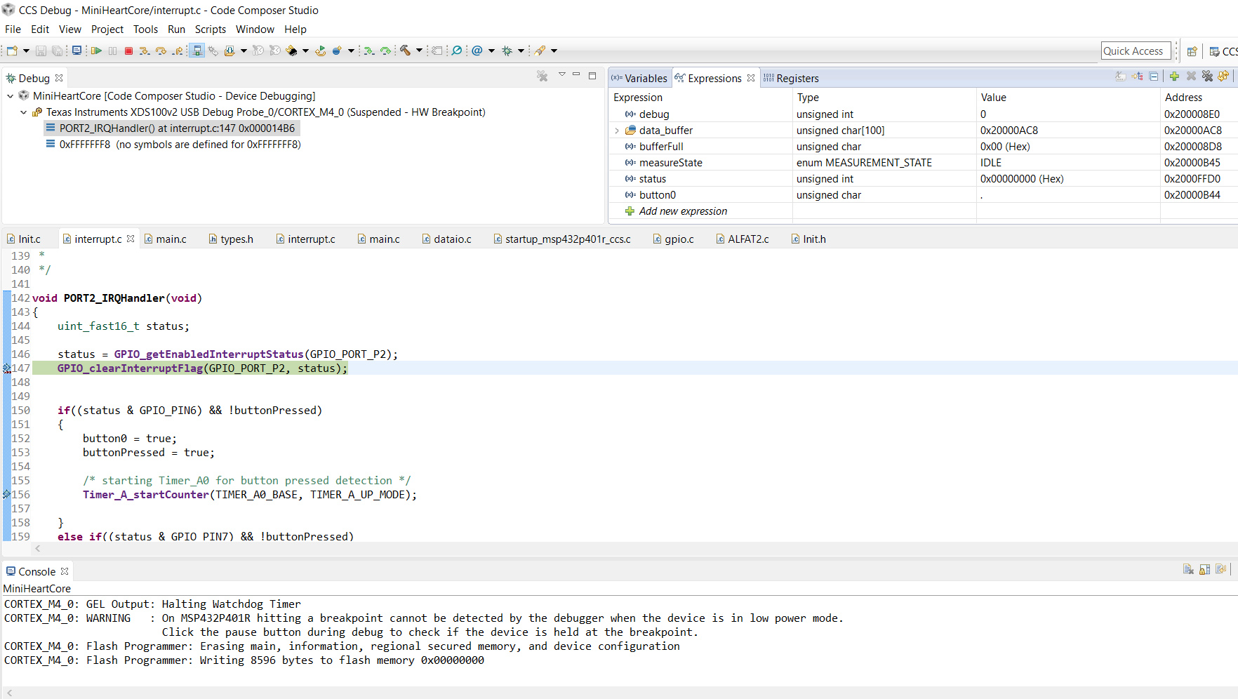

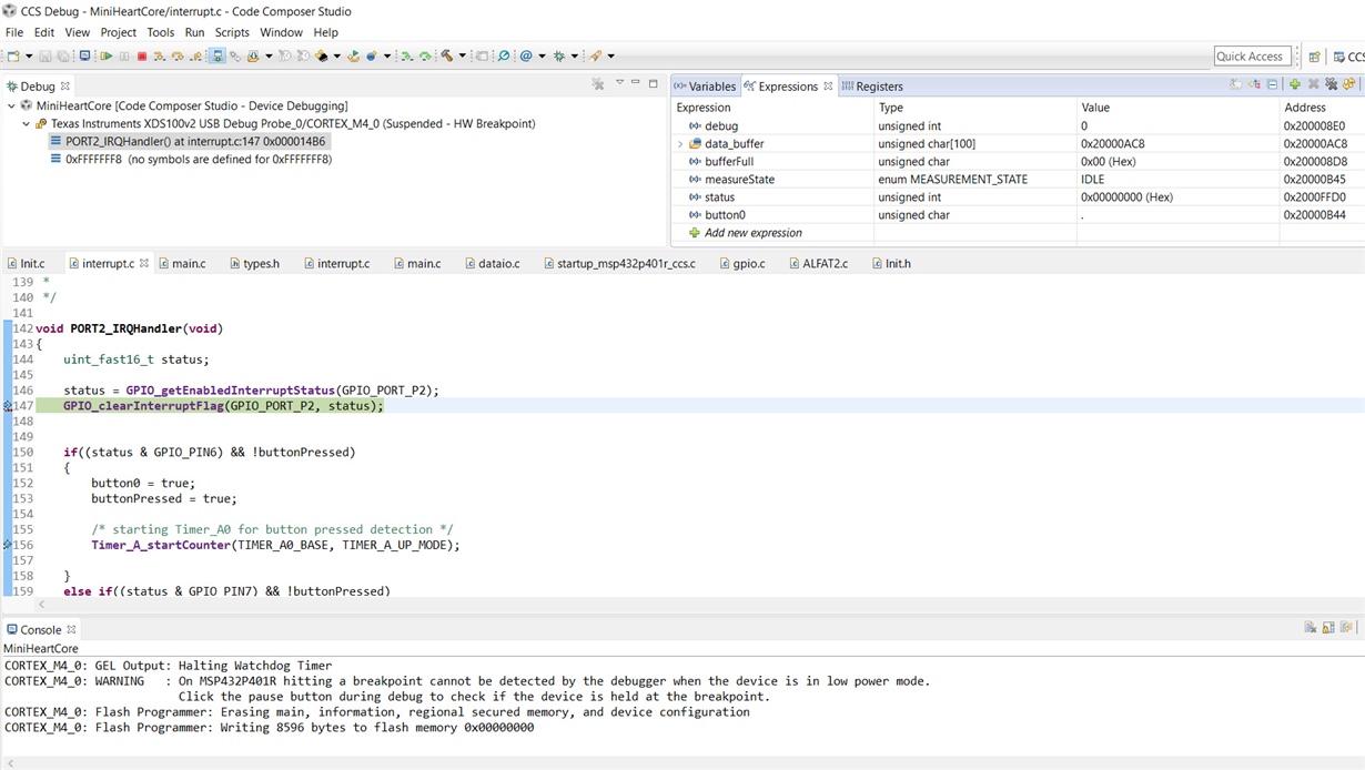

  • very strange. I know tried a full evaluation after the factory reset. It seems there's something wrong with the API...
    When I press one of my buttons at P2.7 or 2.6 the appropriate interrupt is enabled and the programm jumps to the ISR, but i don't get the correct value from the GPIO_getEnabledInterruptStatus(GPIO_PORT_P2) API. It returns zero..what is basically impossible. I made two screenshots where you see the variable content of status and the register values of PORT2. And the registers show, that the MSP does recognize the correct interrupt, but the API doesn't handle the right data to the varibale..
    and here the regiters

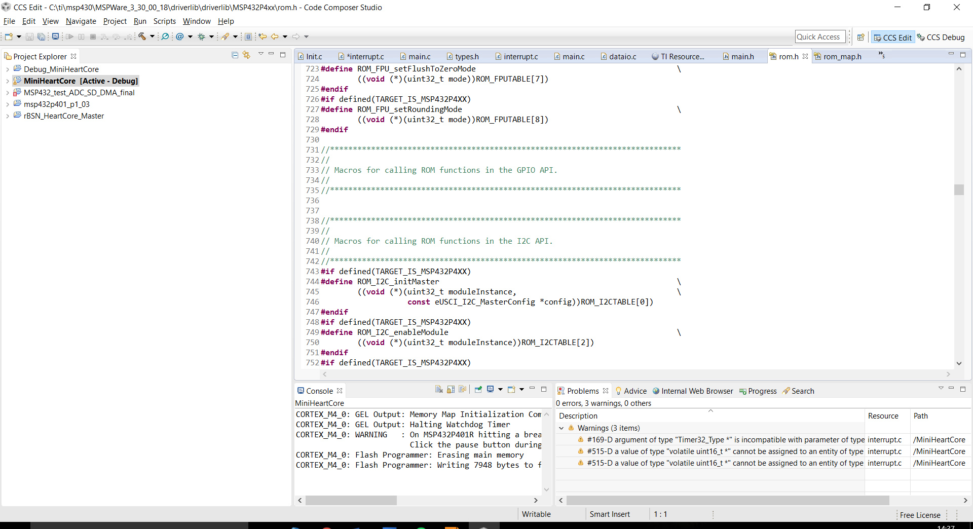

  • when i use low level register programming it works fine. so there is obviously a problem with the API
  • Ben,
    Which version of the MSP432 Launchpad are you using? The black board or the red one? Your issue with the API not functioning properly makes me think of the CMSIS update that was done to the APIs. Basically, if you have the older board, the newer APIs won't function properly. If you still use the APIs that are located in ROM though, you should be fine no matter what version of the board you use. Please see the following Twiki page for information on this and potential workarounds.
    processors.wiki.ti.com/.../MSP432_CMSIS_Update
  • Hey JH,
    thanks for your fast reply. I am not using the Launchpad (but I have the black one). Instead I am using a custom board with the XMSP401RIPZR. It was purchased around April this year from TI.
    But it's strange..wouldn't the Processor use the ROM APIs when I don't use MAP_ ? Basically I also tried that but it didn't work. Maybe I need to clean the project first and then rebuild it again?
    best regards
    Benni
  • ah ok, have to use the ROM prefix, sorry ;)
  • sadly the ROM version of GPIO APIs do not exist :(
    so i'll just keep it with the register programming.
    I must say, I am quite dissapointed about that..
  • Ben,
    Since you are using stand alone pre-release silicon, we cannot guarantee full functionality with the current SW offering. We have recently RTM'd (fully released - No longer says XMS on chip) MSP432 and some changes to the SW offering were needed to be made for various reasons. Unfortunately some of the more current changes and the changes made for the CMSIS compatibility has made some of the APIs not function correctly on the earlier versions of the pre-release silicon. Growing pains for sure, but they could not be avoided.
    As you stated, register level programming will work fine, but if you want the APIs , you will need the released silicon for this.
