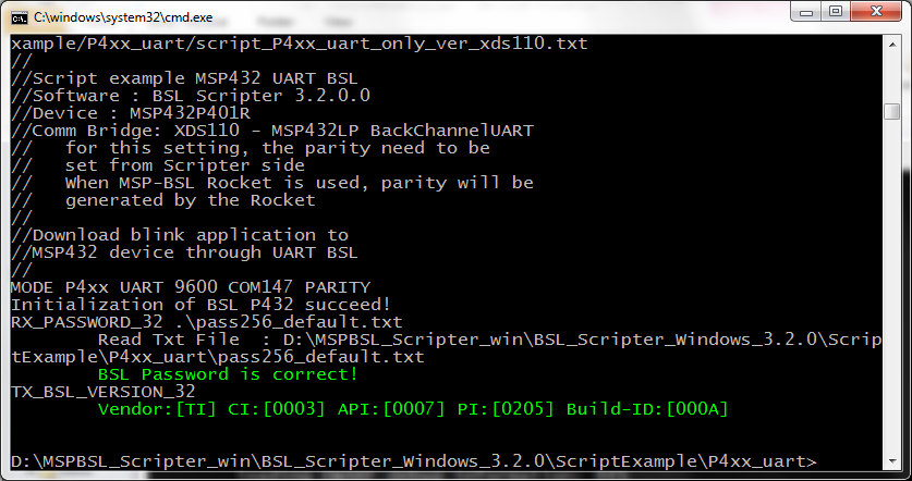

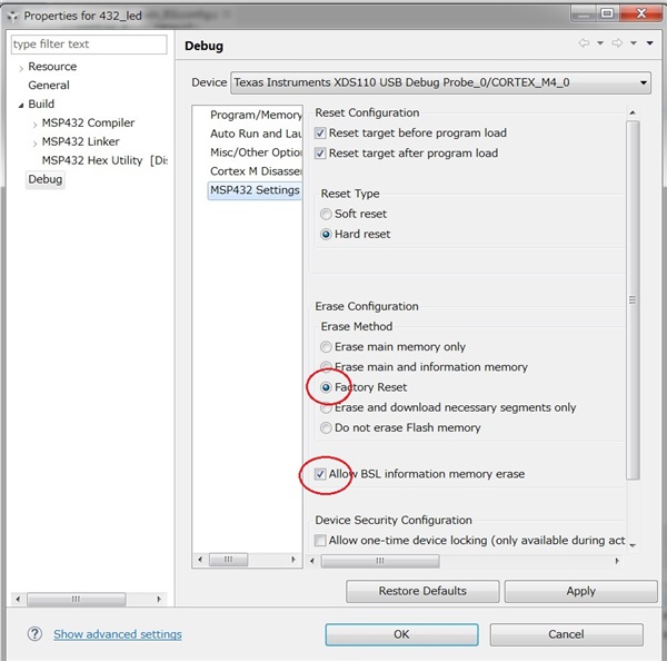

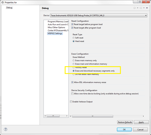

BSL Scripter v3.1.0 can write an example program, after Factory Reset to the non-blank device.
I had discussed these operations on e2e.ti.com/.../2021272
But under the same operating condition, BSL Scripter v3.2.0 can’t access the device, not getting responses.
Both logs are as bellow,
BSL Scripter 3.2.0
PC software for BSL programming
2016-Nov-14 13:35:48
Input file script is : D:/share/BSL_scripter/432BSL_LED/script_P4xx_uart.txt
MODE P4xx UART 9600 COM40
(No response)

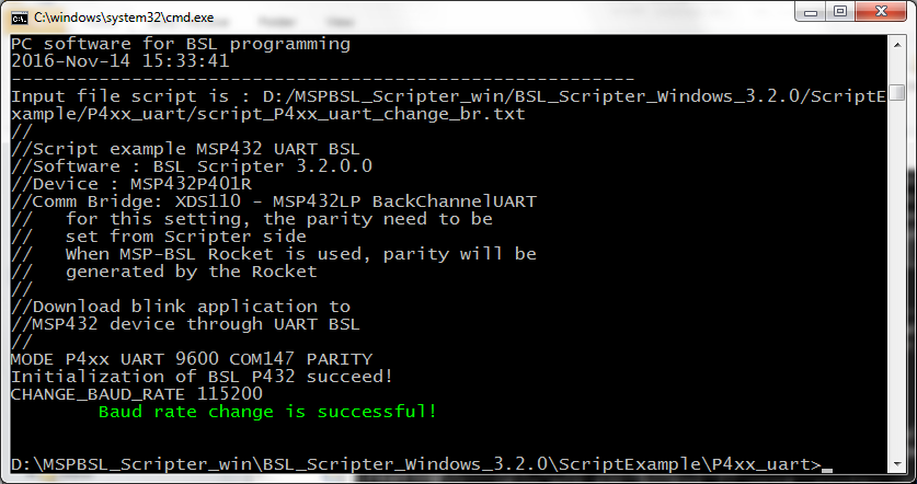

BSL Scripter 3.1.0.0
2016-Nov-14 14:10:18
CHANGE_BAUD_RATE 115200
BSL ACK is received.
