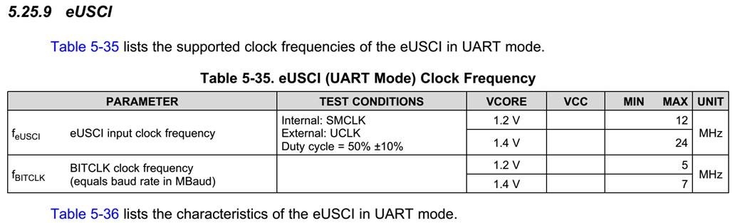

Dear Champs,
As MSP432 datasheet said, if VORE is 1.2V, we can drive UART baud rate up to 5Mbps when BRCLK=12MHz.
After testing, I met higher error rate when setting 4Mbps baud rate.
Do you have any suggestion or this?
I use “msp432p401x_euscia0_uart_01” project to test it. Below is setting:

If you have any suggestion, please feel free to let me know.
Thanks a lot.
