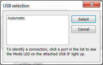

    - Not being able to find the com port is also the problem I saw when I use IAR-Workbench V5.51.6. Following is the screen shot of the window used for selecting the com port. Normally for older POD, a com port appears here. However note that in this case, there is no com port listed, indicating that IAR didn't see the device on any com port.

  • Hi Satyajit,
    You're absolutely right. I saw where the Technical Note says "applies to IAR Embedded Workbench for MSP430 versions 5.40.x and 5.50.x", but I completely missed the section that says "Since IAR Embedded Workbench for MSP430 version 5.51.x, it is no longer possible to use the v2 version DLL or firmware (since the firmware API has changed)".
    With this in mind, take a look at the following IAR Technical Note.
    Basically, you'll want to download the latest 'MSP430.dll' and 'hil.dll' from our MSP Debug Stack product folder (MSPDS) and copy it into your IAR's \msp430\bin folder (replacing the existing files). Make sure you keep the debuggers unplugged when you do this. After downloading and installing these files, I'd recommend power cycling your PC, opening IAR, and then plugging in the MSP-FET. Open your project, click "Download and Debug", and then you should see a window pop-up asking you if you'd like to update the firmware on your MSP-FET. If so, select "Yes" and after that's finished, you should be able to utilize the MSP-FET.

  • Thanks, James,
    This seems to work. The new version of MSP430.dll was the required update. Thanks. Just out of curiosity, I could not find any hil.dll in the package I got from MSPDS. Let me know what I am missing. Thanks.

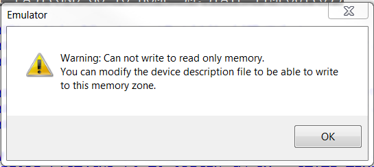

  • James,
    Another problem has crept up. Just after the program is downloaded to target and before it shows me the execution location at the start of main(), I get following window:
    This used to happen with the old pod, but infrequently. However, it's persistent in the new setup. I had largely ignored this in the past because it used to only happen if I tried downloading a new code while the target is in the middle of execution. Now it seems too frequent. Let me know your thoughts. Thank you.
  • James,
    The new MSP430.dll seems to cause this. Beacuse with the new dll, my old programming POD is also showing above warning. That in itself is not super significant, but there are other issue that have crept up: such as the program hangs between two break points. Then if I stop the execution and then do an appropriate "run to cursor" command, it will resume and more-or-less behave normally. This is unsettling because I am chasing a unrelated bug in the system where the system is resetting unexpectedly only when debugger is attached. Please comment. Thanks.
  • Which specific MSP430 device are you using? Keep in mind that timings can be affected when the debugger is communicating with the device. I searched for the warning online and found the following thread that may be helpful.
    Also, make sure you're not trying to manually write to a memory address in your code that's outside the range(s) defined in your linker command file.
    James
    MSP Customer Applications
  • James,
    I am using MSP430F5310. I am simply compiling code using IAR's workbench. My code is standard C. I don't dorce any variables to any specific location.. All done by the compiles. i.e. No manual vaiable writing. I have read the thread you have pointed, but it does not offet any insight in this case. Thanks.
