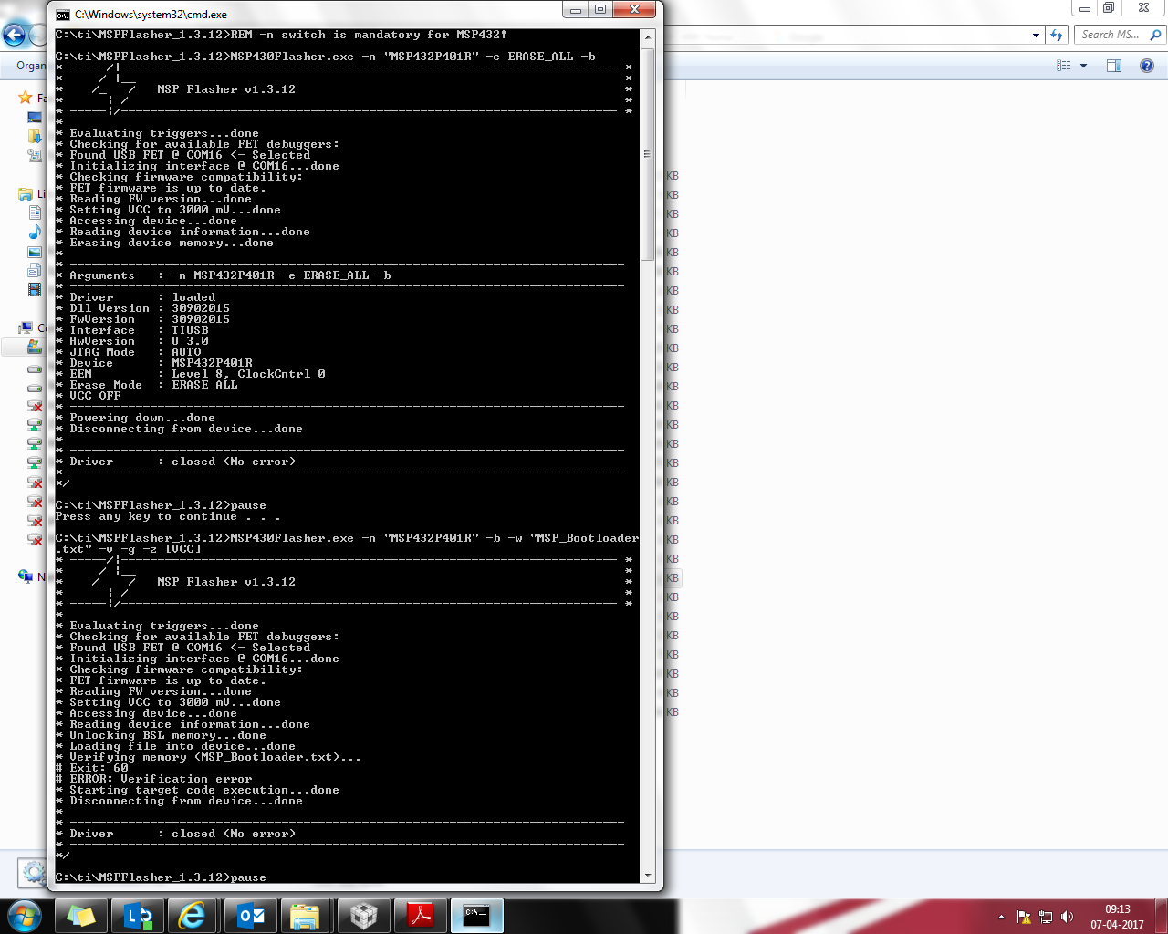

I am using "MSP432P401R" in my project and MSP-FET debugging Downloaded MSP-flasher 1_03_11_00 version for SW flashing through MSP-FET ADPTR Rev1.0. After firmware update is successful it throws Exit 60: verification error. I am using the below commands and switches
CLS
REM -n switch is mandatory for MSP432!
MSP430Flasher.exe -n "MSP432P401R" -b -w "MSP_Bootloader.txt" -v -g -z [VCC]
pause MSP430Flasher.exe -n "MSP432P401R" -r [FirmwareOutput432.txt,BSL]
Pause
    I just want to confirm that you are trying to update the BSL, please let me know if that is not the case.
    Also, could you please send me your MSP_Bootloader.txt??
    At the same time I will run a few tests on my side.

  • Hai,
    Thanks for the response.
    yes, I am trying to update BSL. BSL file is MSP_Bootloader.txt
    MSP_Bootloader.txt contains (this file is also attached here) the 'BSL code' and also 'small application code'.
    Application code is starting at 0x00000 location and BSL starts at 0x202000.
    This application has the code to jump to BSL based on external switch.
    I observed that after flashing the MSPBootloader.txt (with the procedure in the previous post) application SW is running. After the external switch is operated then SW control is going out of application SW but seems not entering the BSL code.

  • I think I know where the problem is:
    The MSPFlasher doesn't erase BSL memory properly when -b is added. This is a bug and will be fixed in the upcoming release that is planned for mid of May.
    A workaround for this issue is to change your batch file the following:
    CLS
    MSP430Flasher.exe -n "MSP432P401R" -e ERASE_ALL -b
    pause
    pause
    pause

    I tried with the script changes you have suggested but still facing the same problem. Screen shot is attached.
    I have tried flashing ONLY application SW and it works fine but if I include BSL code as part of MSP_Bootloader.txt then verification error is reported. I have used for 1.3.12 version.

  • Hey,
    I wasn't able to reproduce this with MSP432P401R Rev C, so I tried with MSP432P401R Rev B and was able to get the same result.
    Very strange that the behavior is differently.
    To get it working on your side you will need to add another -e ERASE_ALL to the script:
    pause
    MSP430Flasher.exe -n "MSP432P401R" -e ERASE_ALL -b -w "targetCode/MSP_Bootloader.txt" -v -g -z [VCC]
    pause
    Hope this will resolve your issue.
    Bob Heilmaier
  • Hi Bob,
    Thanks for the suggestion.
    But unfortunately I am getting same error. Am I missing any settings? Why this error is popping up only when I flash BSL memory location and not for application SW?
