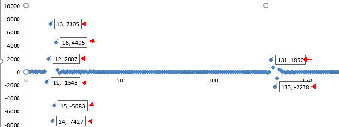

fr5994 real FFT result
i am  using FR5994 to analysis signal ,the signal is made of two signals:
1、singal with frequency 200Hz,amplitude  0.6
2、signal with frequency 2100Hz,amplitude 0.15
the Fs = 8192Hz,after N = 256 point real FFT ,the result coming into being as the figure above.
so  what's the figure above representation? for example, what is [13,7305]  mean?
that is to say how can i get the Frequency-Amplitude  of  the signal from the figure?
    Based on the information presented not sure.
    How was the figure produced?

    after doing FFT,the result about the figure is the array of which the input pointer point to.
    status = msp_fft_fixed_q15(&fftParams, input);
    The posted code appears to be the MSP DSP Library transform_ex1_fft_fixed_q15.c example.
    Does the following description of the example help answer your question?
    This example demonstrates how to use the msp_fft_fixed_q15 API to transform a real input data array to the frequency domain using the Q15 fast fourier transform (FFT) with fixed scaling. The real FFT function is identical to running a complex FFT with imaginary components set to zero. The result of the real FFT is a complex vector with half the samples but identical byte length.
    See Computing a Length N/2 Complex FFT from a Length N Real Input Sequence for some more information.
  • OK I know what the out put of the FFT fuction measn. by the way, does the LEA support higher point FFT?
