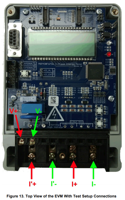

Hi. I just received my EVM430F6736 test module and I do have some questions about it. If I am to supply it 220 VAC, where do I plug on the terminal lugs? because the wires from the LINE/NEUTRAL source is not connected to the terminal lugs. Please help. Also, I noticed that the AGND is shorted with the DGND is it ok? Thank you.
    Are you using a test setup that can provide independent RMS voltages and currents? If so, you'll want to connect Line (220VAC) to V+ and then Neutral to (V-) on top of the terminal block. For the current, you'll want to connect across I+ and I-. These connections can be seen in Figure 13 in the User's Guide.
    If you're not using a test setup and want to connect an actual load (versus the simulated load by the test setup), you'll have to connect to the EVM differently. If so, please refer to Figure 2 in the User's Guide. Basically, you'll want to connect Line (220VAC) to I+. Then, connect I- to V+ and one side of your load. Connect the other side of your load and V- to Neutral. Obviously, the wires connected from Line through I+, I-, your load, and back to Neutral will need to handle the current consumed by your load. The connections to V+ and V- are for sensing Line and referencing Neutral, so they aren't going to be carrying the current of the load.
    In Figure 2, it appears that the "I1+/-" notations should be reversed with "I2+/-" connections as shown in the schematic. At the top of page 17 in the User's Guide, it mentions that although the EVM hardware and software supports measurement for a second current channel, the EVM obtained from Texas Instruments does not have the second sensor and any current inputs must be connected to I+ and I- only. If additional sensor needs to be placed, please use the two bottom left slots close to terminals I’+ and I’-. Additional connections need to be made to connect the output of these sensors to points CUR1+ and CUR1- on the PCB.

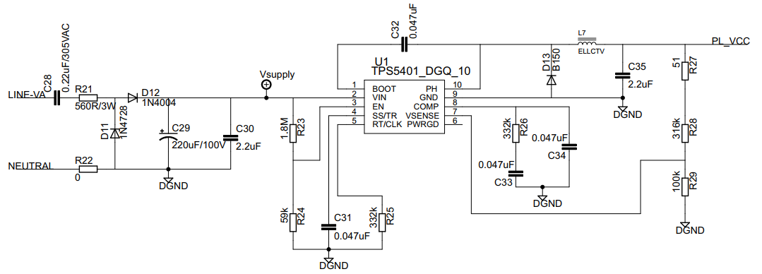

    Thank you for your prompt reply to my inquiry yesterday. I have another concern right now, I noticed on the schematic diagram that I've downloaded, the DVCC appears to be from an external source and it doesn't seem to be connected to the power block. Please confirm.

  • Hi James,
    I've tried your suggestion on powering the EVM and i'm still getting the same result. Furthermore, I've supplied 22VAC to the V+ and V- terminals then measured the DC voltage going to the TPS5401. The input voltage going to the requlator is 39VDC but i'm not getting any power on the R27 node. I also supplied 3.6VDC from an external to check the LCD and it worked. Are there any problem on my DC Regulator?

  • Hello Nereo,
    Did you mean to type 220VAC instead of 22VAC? If you're measuring 39VDC at the TPS5401, then I would assume it's 220VAC. If you have JP4 set to PL_VCC and 220VAC applied, you should be measuring 3.3VDC to 3.6VDC at R27. Could any of the components surrounding the TPS5401 be damaged or are missing? Is there a possibility that the output was shorted to GND?
    It may be helpful to refer to the datasheet of the TPS5401 during your debug efforts.

  • Hi James,
    Sorry I supplied 220VAC not 22VAC on the EVM. We don't see any issues on the input side of TPS5401 wherein we're getting 39V but the output side doesn't still provide any voltage. I've also checked the components surrounding the TPS5401 and I don't see any problem. It seems that the TPS5401 is defective and we look forward to get my EVM replaced thru Mouser Electronics.

  • Hello Nereo,
    I would recommend checking the resistors related to the TPS5401. Refer to the schematic for the correct values. Unfortunately, I suspect that resistors with wrong values were placed incorrectly when the EVM was manufactured.
    These resistors include:
    • R23 (1.8M)
    • R24 (59k)
    • R25 (332k)
    • R26 (332k)
    • R27 (51)
    • R28 (316k)
    • R29 (100k)
    Try replacing these and see if the TPS5401 works. If that still doesn't work, please let me know.
