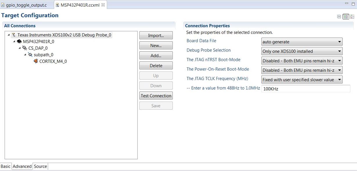

The first day I can be normal use XDS100V2 simulation MSP432, but the next day have an error.Use two boards, the same result.
The following is the error
Unable to access the DAP. Reset the device, and retry the operation. If error persists, confirm configuration, power-cycle the board, and/or try more reliable JTAG settings (e.g. lower TCLK).
The following is TEST Connection

[End: Texas Instruments XDS100v2 USB Debug Prob
How can I solve this problem
Thanks.
