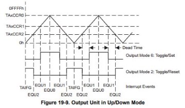

  • Will,
     If you are trying program the two PWM periods separately, then how do you expect to maintain an offset between the signals? Ultimately one PWM would sweep across the other and you would not maintain a phase relationship that way.
    Assuming you keep the periods the same, then I would recommend that you use the same timer and just adjust the duty cycle using different Compare registers from the same Timer- there are 7-(CCU0-6) per Timer. The multi-PWM example from TI Resource Explorer is "timer_a_updown_compare_multiple_pwm.c". This shows the independent setting of CCUs to control two PWMs. You can also see this described in the MSP432P4 Technical Reference Manual in section 19.2.3.5. The diagram below is from that section and shows how the CCUs are configured to generate multiple PWMs.
    If you really need two Timers (for fully independent Period, for example), then you can still set each Timer's CCUx registers to set and reset the output at selected points in the count.  You can also get the two timers to start at (almost) the same time by setting the TACLR bit in each register in quick succession. This would of course still introduce a small offset since the counters would be reset a few cycles apart, but it might be workable in your application.
    For your case using TA0 and TA1, once you've configured your counters, use the following code snippet to reset both counters
    TIMER_A0->CTL |= TIMER_A_CTL_CLR;
    TIMER_A1->CTL |= TIMER_A_CTL_CLR;
    Let me know if this solution would work for you.
      Bob L.
  • Bob,
    Thanks for the clarifications, I understood about the timing between 2 different timers, I will do the project adjustment and I will work on the same timer.
    About PWM generation (compare_multiple_pwm) I do not see how I can vary the Phase Shifted between the two PWM signals. You can explaning for me?
    Thank you.
  • In its code, CCR3 and CCR4 do not change the PWM. Only the Value of CCR1 and CCR2 are required to generate the same signal. Am I doing something wrong?
    Follow the complete code and result Image-1.

  • there is no mechanism to "sync" across multiple timers - the approach provided earlier aligns two timers sufficiently closely, but not synchronized.
    the easiest way to perfect align two pwm signals is to generate them off the same timer, on different channels.
  • Hi Danny,
    Yes you are right. This timing problem between two different Timers is solved with the code above. Now the problem is the PWM frequency.
    I can not switch PWM outputs with higher frequencies with this code that I am using.
    The Processor is already running at 48Mhz and I still can not, for example, generate an output with 100ns of period for example.
    Anyway thanks a lot for your comments.
  • I think you aren't listening to bob landers' suggestion carefully. using timer32 interrupts to generate pwm will NOT get you anywhere to 10Mhz output, simply because of the overhead + ISR execution time.
    what bob was saying is to use the timera's output compare feature. take a look at the datasheet and read his suggestions.
    BTW, if you are really in need of 10Mhz pwm, rethink and triple-think of your approach and think of a dedicated pwm chip.
  • Will,
     What you are seeing in the 100kHz limitation is just the inherent difficulty of trying to use a CPU + interrupts to do something that dedicated peripherals / hardware are meant to do.  In this case, you are using the CPU to do the TIMERA capture/compare modules function.
    If you really must have PWM frequencies as high as 10MHz, then you might want to switch to TI's C2000 products, which have a more feature-rich PWM module targeted at the industrial space, at the expense of additional power compared to the MSP432.  One example product is the TMS320F2837xS, (see datasheet).  The 2 features of interest here are the higher CPU clock (up to 200MHz) and (more importantly), an enhanced PWM module that can create the variable-phase-offset that you want from a pair of PWM outputs. The device also has a high-resolution comparator on some of the channels for edge placement beyond the 5MHz / 20ns resolution of the clock itself.  This might be overkill for your project, but if you're intested, you can get the F2837xS LaunchPad and try it out.  Note that the C2000 has its own processor architecture and driverlib API set, but it's fairly easy to pick up for someone familiar with MSP432 driverlib.
     Bob L.
