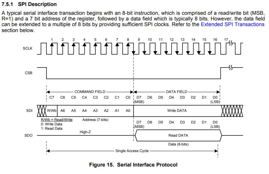

    The LDC1041 uses a standard 4-wire SPI protocol. It initiates a SPI read when the CSB transitions from high to low. Then it begins looking for rising clock edges to latch the read/write bit and address bits from SDI on the first 8 rising edges of the SCLK. Assuming the read command was issued (SDI is 1 on the first rising clock edge) the SDO pin will output data from that register on the last 8 falling edges of the SCLK. After your SPI transaction is complete you should pull CSB high. Note, there is a diagram of the CSB, SCLK, and SDI signals in figure 2 of the LDC1041 datasheet as well as a detailed section 7.5.1 SPI Description. I would first confirm with an oscilloscope the signals all look correct and the timing is ok. If your CSB pin is pulled down out of order or after you've been writing to SDI then you will get wrong behavior.
    Luke
  • Hello Luke and thank you for your answer.
    I did all of that. Mu CSB goes low, then I send the read bit, then the seven bit of the address of the register I ant to read. And after that, I let a few time the CSB low in order to let the LDC answer, but I don't have any.
    My question was : is there a time to respect between the falling edge of the CSB and the first clock? My first thought was yes, but I looked at the eval board (MSP430 + LDC1041 + coil) and the time between these two edges is much larger than the one given in the datasheet (in practice it's several µs).
    So what I did is exactly what is written in the diagram given by the datasheet (except for the timing between the fall of CSB and the first clock) at a frequency of 3MHz.

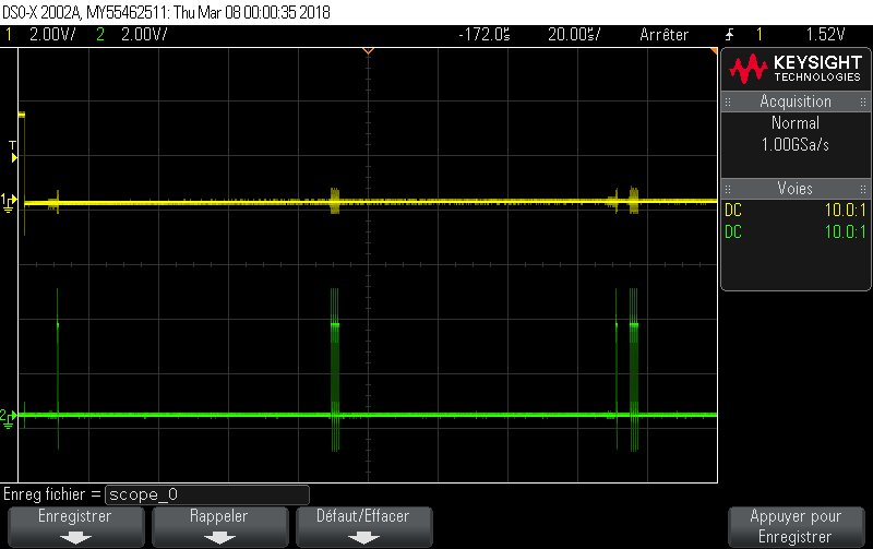

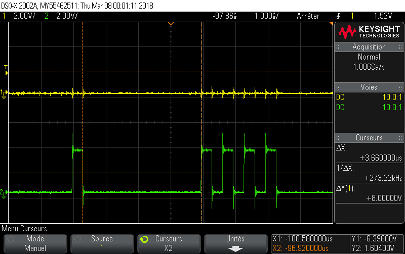

    I send a first command inside the wwhile(1), and a second inside the interruption routine. If i suppress one or the other, nothing works. Any idea?
    I'm now trying to send two bytes of data : one is the register address, the other is the data I want to write. But as you can see on the pictures below, the two bytes are separated by several µs and I don't know why.
    The yellow trace is the CSB signal. The green trace is the data I want to send. As you can see, the first byte (0x01) is send several µs before the second byte (0x55). Any idea why? I think the two problems are linked : the first one being the impossibility to send a data without writting twice inside the TX buffer and the second one is these two bytes separated.
    Thank you very much for your help
    Sylvain
  • Sylvain,
    I would recommend putting some additional GPIO outputs so you can see the timing of your interrupts relative to when you are sending data.
    Chris

    I tried to use GPIO but I can not see anything interesting, except the fact that from one lign to the next, the program seems to take a lot of time : is there a clock to adjust?
    I don't know why, the principle problem is that I have to send twice the TXBuffer in order to have a response. The response from the LDC1041 is synchronized with the second sent of TXBuffer. So I'm wondering if the answer from the LDC1041 is generated by the clock of the second TXBuffer. In this case, is there something to adjust in the MSP432 registers in order to send 16 clocks instead of the 8 clocks that I send for the moment?
    Thank you for your help,
    Sylvain

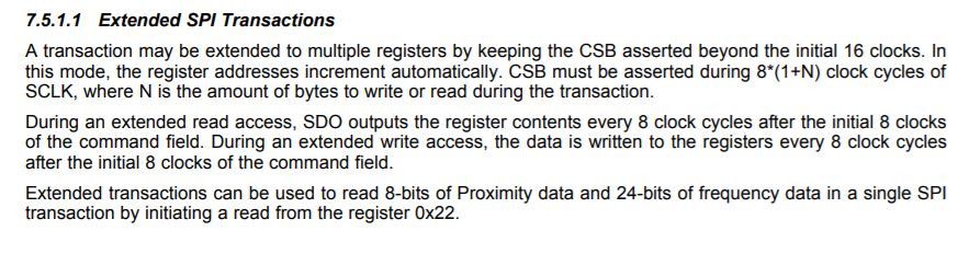

  • Sylvain,
    This is what I found in the LDC1041 datasheet on page 15 (  ).
    The SPI transmitter on the MSP432 requires you to write to the TX buffer in order to receive data (generate a clock).  There is no 16-bit mode, so you would need to write to the TX buffer twice, once with the actual address information and then the second write would be a 'dummy' write to receive the data.  In terms of the RX interrupt service routine you will get one interrupt after the address is sent in which the content of the RX buffer is meaningless and then after sending the 'dummy' write another RX interrupt will occur and this time the RX buffer will contain the read data.
    Chris
  • Thank you very much, all the answers helped me. I'm now able to read and write into registers. The main problem I had was that I didn't pull the CSB HIGH between a write command and a read command.
    In fact, I have to pull the CSB down, to send a first byte with the register address, then the data I want to write. Then I pull the CSB high, then down again and I can send the register address with the 1 at the first bit in order to send the command read, and to finish I send the "dummy" byte and have the data.
    Thanks all

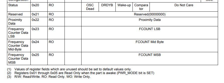

  • Hi all,
    I need your help again.
    I'm now able to read and write into registers but I have another problem.

    Then I send 0xA3 in order to get the LSB count of the frequency counter.
    But I don't receive any response from the LDC1041, from 0x22 or 0x23 registers. I inject a low frequency (about 10kHz) on the external frequency pin.
    Any idea of something I'm doing wrong? Is there something more to do?

    I can check on the scope that my bytes are correctly sent, the CSB is okay and the external clock is oscillating at 190 kHz. But still nothing when I try to get datas from 0x23 register... There is no problem when I get datas from another register. So it seems to me that I forget something important to start the conversion, or maybe a delay that has to be respected?
    Sylvain
  • Sylvain,
       Have you tried to read out the counter using the extended mode?
    Chris

  • Another thing, when I read the register 0x20, the bit number 6 is always at 1, meaning "no new data available". Does that mean that I don't initiate a measure?
    I also tried to use the eval board for the injection of the external frequency : I connected the LDCLK clock to the one of the LDC1041 I'm using, and I linked the digital grounds together. It still doesn't work. The only thing I can see is that there is a timing too long between the sending of the bytes 0x22 and 0x23? Is that possible?
    Don't you have a basic code that could read registers 0x22 to 0x25?
    Thank you
    Sylvain

  • Hello Sylvian,
    The expected operation of the LDC1041 requires several items.
    First, the device by default powers into standby (sleep) mode. You must configure the device in this mode, then set the device active by setting the registers. You need to know several things about the sensor, including the minimum sensor frequency and the range of RP of the sensor.
    After setting the device, you can enter active mode by setting register 0x0B to 0x01. You will need to set the CFB capacitor as indicated in section 8.1.3 of the datasheet.
    You then need to wait for completion of the conversion; you can monitor for assertion of the INTB pin if register 0x0A is set to 0x04. After assertion of INTB you can retrieve the conversion data.
    ChrisO
